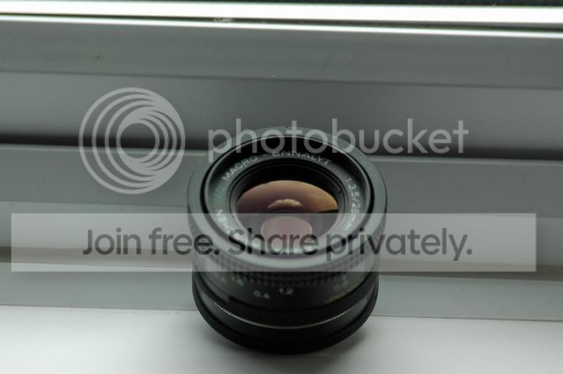

Here are two photo,s one close and one distance, also a shot of the front and back of the lens and to my limited knowledge it does not look like it has been worked on.
