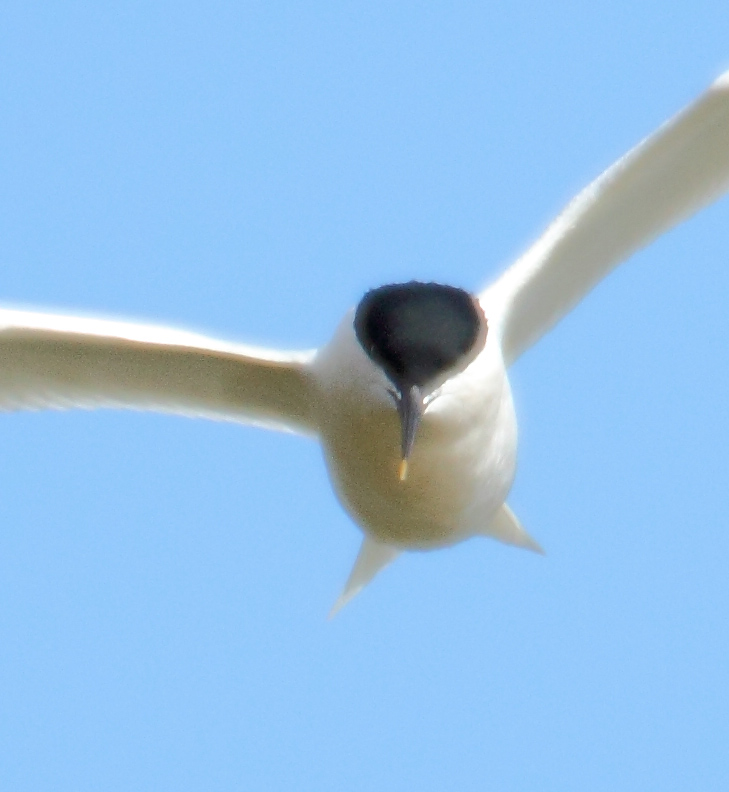

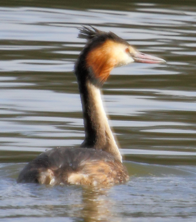

I have a Canon 550D and have just purchased a 100-400L to go with it. Generally I'm really pleased with the lens and the results I'm getting, however I think I might have a problem, certainly something is showing in high contast images.
Two from yesterday both heavy crops to show show the problem:-
If you look at the terns head, there is a distinct blurring between the white body and the black head:
With the Grebe there is a halo in front of the neck:
What do people think - lens, body, combination?
That does look a bit strange, your shutter speeds look ok (1000+)
Have you done any pp on these shots? Are you able to post the images full size? I would say they are out of focus.
Those both look pretty soft to me! How big a crop are we talking about here? If you could post the originals, that would be a great help.
It's quite common to get fringing (called 'chromatic abberation', but spelled differently/correctly ;)) around areas of high contrast, as where you have bright white and dark black.
I could almost bet money both of them are out of focus. Can you focus with liveview manually and then compare the results? If it is still no good then the lens calls for a trip to service centre.

I could accept that the Tern is out of focus - fast moving and I was trying to get to grips with the camera/lens combo, but the Grebe was very slow moving and I had AF servo on.

Hmm, using AI servo might be to blame. Did you select one focus point, or did you let the camera choose?
i think iv,e seen this before in a pair of bino,s one of the prism,s had been knocked out of alignment, possibly a lens group moved. :shrug:
none of this shot is sharp, so i dont think it matters which focal point you choose. as it didn,t focus sharp anywhere. :shrug:
Can't recall as I was messing round so much trying to get used to lens/camera.
