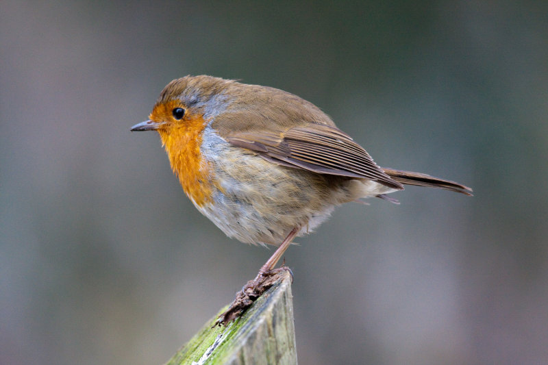

As the man says. Our friendly robin shot in the garden with a 100-400 at f5.6, at about 12 feet away, with the fence behind about 4 feet beyond that, from memory

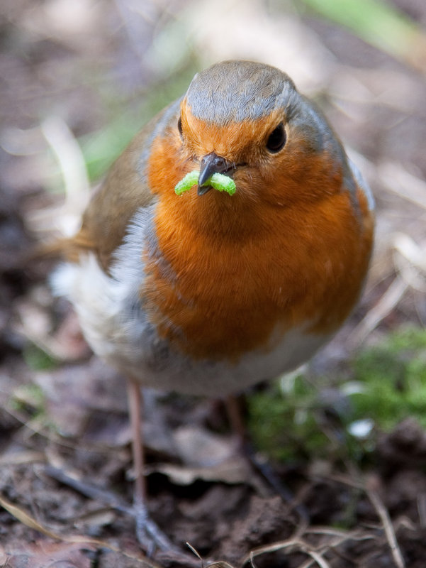

Same bird using a 24-105mm lens at about as close as the lens would focus :D
