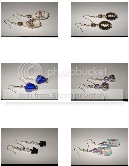

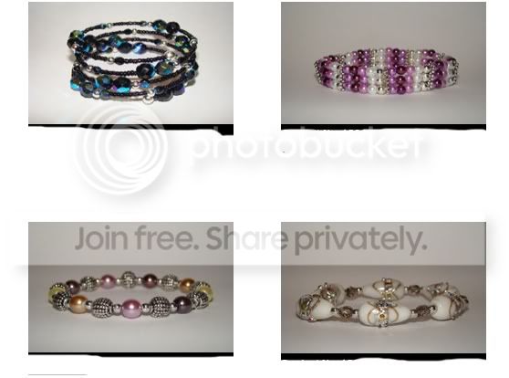

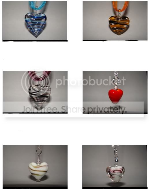

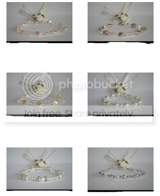

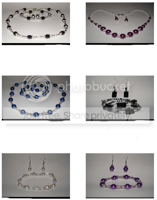

Some photos of the jewelery added not very good quality but gives you an idea of what i will be taking photos of, so anymore ideas on how i can make them look much better.
Do they all need to be on that kind of background? You may need to create consistency, but if you don't then it would be far better to use whatever background suits the colour/type of jewellery, reflective white and reflective black are probably the most useful.
As Richard said, multiple small lights are the best way of adding sparkle. Use your exising studio flash to create an overhead fill light and use hotshoe flashes (or smaller) for effect lights. You can easily make them smaller simply by using black card or blackwrap with holes cut out of it, placed over the flash.
No not at all Garry, i was just posting them as examples so folk could see the type of jewelry it was and the best way to light, i have been looking at these reflective tables (which i suspect your referring to) HERE i think i may get a black and a white one as they are not to pricey, i am also looking at this type of thing HERE although i'm undecided about that at the moment, would my smart flash 200 be overkill on the lowest setting ? if so what type of small lights would you recommend and where from, i'm getting some of the jewelry next week just to have a practice on :)
Yes, both of those links will do the job. The first one is more controllable, because the depth/degree of reflection is easily controlled simply by camera height.
A couple of a3 pieces of acrylic from Ebay would be cheaper and using a polariser will control the amount of reflection that you may want. As Garry has said black and white are the most useful and will let the colours of the jewellery speak for themselves plus you don't need to spend time deciding which coloured backgrounds for each piece of jewellery.
