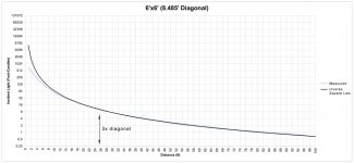

This is a chart that shows the light falloff of a diffused light source verses a very hard point light source (the Inverse Square Law). The main thing to take away from this is that falloff increases rapidly when the subject distance is less than ~ 3x the diagonal/diameter for a diffused source. And by approximately 5x the distance the diffused light source looks and acts like a hard light source. I.e. there is no point to using small modifiers from large distances.
Because the distance is shorter, the power must be lower, and the light travels less distance... If you cannot get the power low enough, just add more diffusion. You cannot move the light farther away, because that makes the light harder and the rate of falloff less. This shows the fallacy of changing the distance to change the softness (apparent size)… that works, but it affects only one aspect of lighting character. And you cannot just change the camera exposure settings, because that doesn’t change the lighting ratio or where it’s falling.
