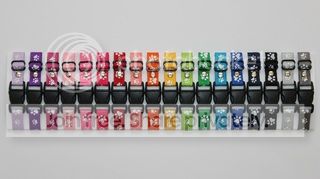

I sell products online, and looking for a lighting kit. I'm really not sure where to start. The items I sell are laid out flat on a white surface and need to be photographed mainly from above. Items are around 15cm - 50cm by approx 10cm and a few mm high.
It would be great if you can advise on a lighting kit, and a white surface and white background as I sometimes take photo's from the front.
I have a canon 500d.
Thank you in advance :)
Two older pictures but gives an idea of what I'm trying to photograph, I would like the background colour to be consistent and a get a true colour of the products.
Those dog collars could be lit much better. The light is much too far away and is pointing straight down.

Be aware though that the background will not photograph as white, when arranged as in your sample pics.
You would need to place the products on a sheet of glass, have the background a few feet below the glass and light the background separately, with at least one other flash head. Even so, care is needed to get the background pure white but without overexposing it to the point where it reduces image contrast and eats away at the edges of the subject. A more professional way of doing it is to photograph it on a white paper background and cut it out on computer, a quick and easy job.
