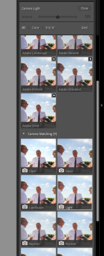

Hi there
I am wondering what Profile fellow Sony photographers find the best one to use in lightroom. I have always used Adobe colour however, I have also always struggled to get the look I am after with skin tones from the sony files. Do any of you find the camera matching profiles better suited?
Thank you,
Gary

Lately I’ve used the PT Sony profile in lightroom, it’s better than Adobe but still needs tweaking imo

Adobe standard is always a better starting point than Adobe color. The former is flatter and more neutral allowing you more processing latitude. Your camera may also show Adobe standard 2 or something like that in which case maybe use that. Adobe portrait may also be a good starting point; in my experience it is almost identical to standard.
