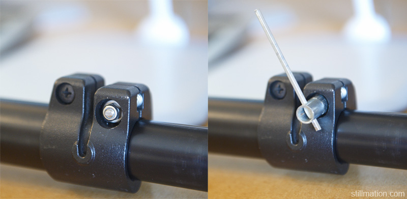

hmm, I have the 682B and had a sliding clamp too.
I just tighted the nyloc nut on the back of the lever section of the clamp.
If it's the main screw, maybe release it completely,check for cracks and refit with some threadlock?
Like so..
The little socket spanner came with my Manfrotto studio stands and fits all their products. Seems a standard size for all these types of clamps too. It lives in my camera bag.
Looks like a 7 or 8 mm socket tony, should be able to tighten it no bother. Any problems i can look at it this wk if your around
ah ha!!!! THANKS TREBS for the pic.. on mine theeres screw and bolt clearly vissible but above that its just a cover over a bolt.. until i saw the pic i didnt know it was a cover.. now i do i got it off and can tightwen ... cheers
the confusing bit was.. why have a cover over one and not the other.. hence why i didnt think it was :)

all sorted... feel a bit daft really.. i had thought they where covers over nuts but then thought no.. why cover one and not the other... like anything else.. easy when you know how... many thanks... ya just gotta keep loving this place havent ya:)
