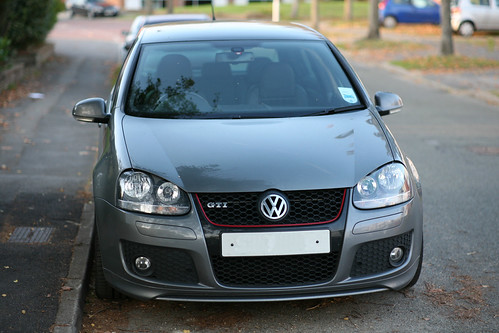

My Leica arrived last night, so I popped outside to try a couple of tests on the car (I'm hoping to have a proper play with it this afternoon)
VW Golf Edition 30 by cloud34.com, on Flickr
I'd say the signs are promising with this lens though.
