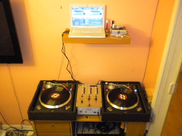

This is how it's setup,

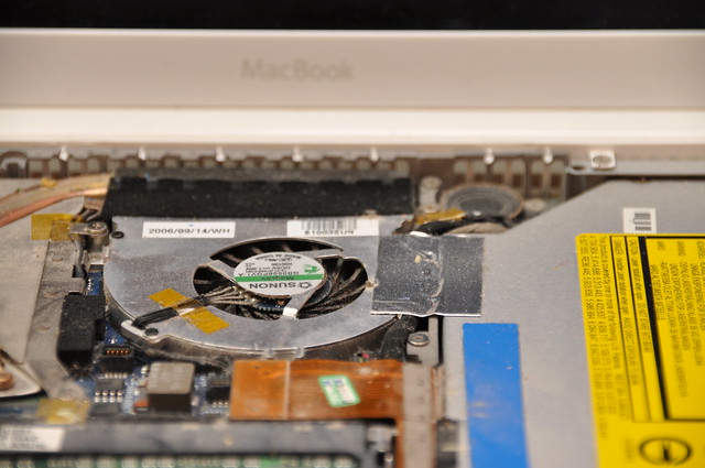

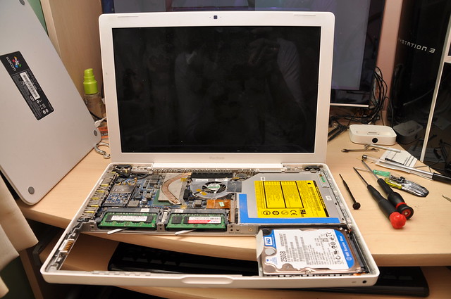

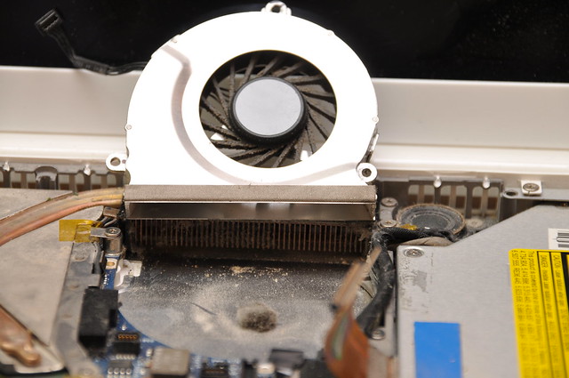

anyways I'm going to take the cover off and clean the inside of any fluff, re-paste if needed.

Partially disassembled MacBook
MacBook Fan
Fan Dust
