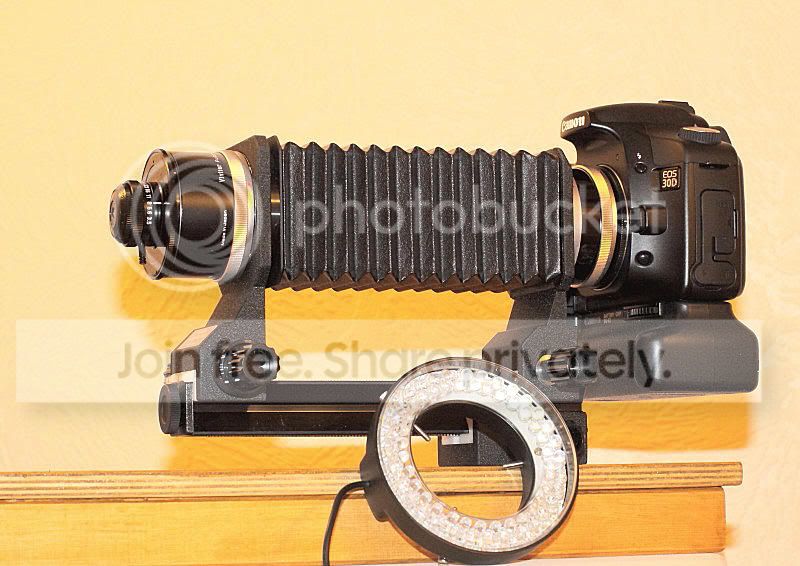

A few folk have asked about a macro rig that I'm putting together so here it is.
From right to left;
30D....EOS-FD adapter plate.....15mm FD tube.....FD Auto Bellows....25mm FD tube.....lens adapter plate.....20mm f/3.5 Canon macrophoto lens.
Tubes can be added at either end to increase magnification but in the configuration shown then it should get close to 20x. The LED ring light assembly is a 48 by 5500k variable intensity set up although the minimum light distance is just a little too far out at the moment and a better one is under construction.
The front element is mounted in a chamferred extension to allow the light source to come from behind the lens and this is essential with a working distance <10mm.
Initial shots showed the lighting limitation but I got as far as 2mm fitting across the sensor width. DOF is "quite thin" :(.

:eek: that is one hell of a set up, not the sort of thing I would ever try to replicate!!
Hi Bob, I have the same setup and have been able to photograph grains of pollen, although not very well. It's very difficult to see anything when the lens is stopped down, so I opened the lens for focussing, by the time I stopped down again the focus point was different. It was a lot of fun and incredibly frustrating at the same time. I keep meaning to have another play.

That's damn good Richard. My early attempts (lighting restricted) were showing the leg joints of a dead fly. Hopefully, I'll find something with more general appeal :shake:

I'm currently up to a measly 5:1 with this setup - a nifty fifty reverse mounted. i'm currently looking for a 20mm Nikon which when reverse mounted will get me 11x with a working distance of approx 35mm:D , as you say the main problem is light or the lack of it :shake: and DOF

I'm not sure that it would be beneficial. The lens to subject distance is less than 10mm at higher magnifications and so the light needs to get in there. Too much light coming from the sides is going to degrade IQ by flaring.

The concept here though is that this is cobbled together using 1970's and 1980's left over kit...apart from the lighting in which white LED's have a big advantage over bulbs (no heat).
