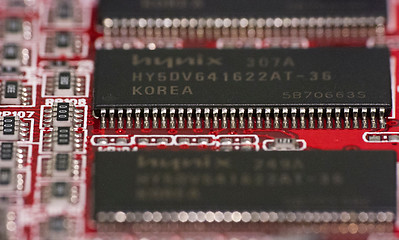

I have taken macro shots of a graphics card with a 70-200 and a Raynox-250 filter:
(Hope this shows up)
