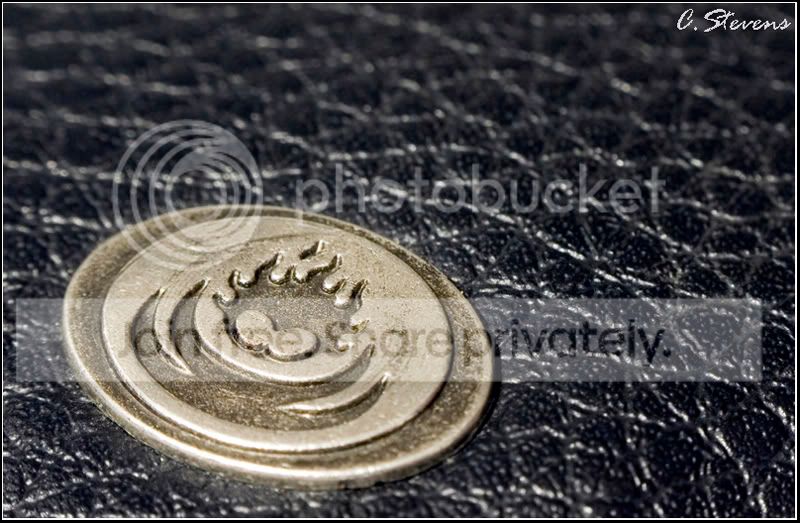

Here's something I took (Saltrock leather wallet) with the DCR-250 attached to a 18-55mm IS lens. The logo's slightly smaller than a 5p coin.

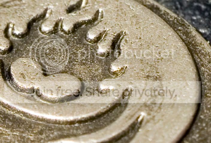

100% Crop.
I'd suggest the Raynox also. You can really get in close with it and a telephoto (I use mine on the 55-250), yet maintain full control of the lens and AF confirm.
