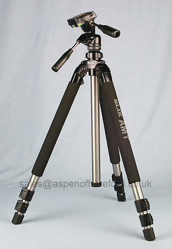

I went for the SLIK PRO 700DX
It weighs 3.2KG, Can hold 6.8KG and the foam leg warmers make carrying it on a cold day a bit more comfortable.
Going up to 1.9m means it's good if you're tall.
Holds up fine to Highland blasts !
