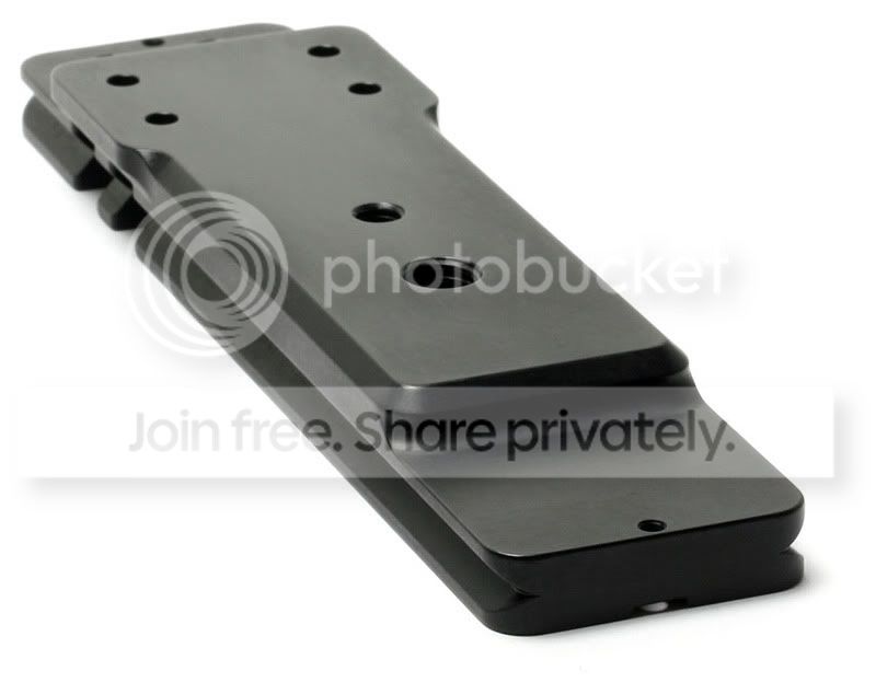

So if i want to mount it on top of the bracket i will have to get a lower profile tripod mounting bracket :shrug:
oops sorry that post sounds a little rude, hope it didnt come across that way
Many thanks for that Mark, i'd had a quick look on the wimberley site but hadn't spotted that.
