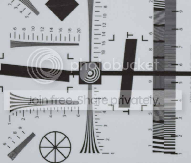

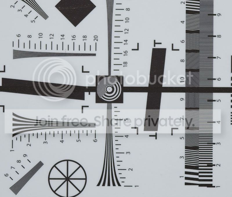

I just use a chart to do mine till I get best focus.
No Adjustment.
+20 micro adjustment.
Now I am really p1ssed of with canon.
I amazed that they could return the body and lens in that condition. You may have already answered this somewhere but what happens when you stick the lens on another body?
