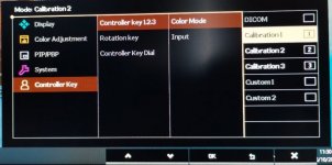

If the GUI is anything like the SW series (pre-supposing) in that you can store up to 3 hardware calibrations on the monitor i.e . Cals 1,2 & 3.I have a setting in there for a PRINT Calibration and one (a default) for sRGB and another for a normal viewing calibration at 120cdm using a full PMU calibration for the monitor ..... but I still cannot figure out how to assign a calibration to a number ....... I did, assign a calibration to number 3 a week ago, but I don't seem to do it again in the PMU software when I calibrate ........ so I use the menu to see the "calibration" and switch using that, (rather than a button), ......... (reading what I have said .....maybe I have not made myself clear?)
What you do is, using the monitor buttons, navigate to the appropriate section of the GUI and allocate the Calibration 'number' to your desired puck button.
Sorry, not on my PC now but will try to update with some more details when I look at my settings......to remind myself. NB I will see if I can do a screen grab or two(?) as appropriate.Thanks
You will have to explain that simply to me Laurence
1). When I calibrate using PMU - I get an option to save as Calibration 1, 2 or 3 as well as naming the ICC
2). If I use the puck I can see the calibrations if I go to Color mode with the "puck" ........ if I want to use one of the Calibrations I change them here
Q: how can I assign a Calibration to a number, 1.2. or 3 on the puck...............I manged to assign one to button 3 last week but I cannot remember how I did it
Q: where do I find the GUI using the "buttons: underneath the monitor?
