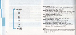

The mju ii has six flash modes (see manual page 50 onward https://www.scribd.com/doc/62156507/µ-mjuː-II-Manual). The main one is Auto so if you have a bright room and/or fast film then it does not always decide you need it. The fill in flash mode is the forced flash setting but resets to Auto when you close lens cover so have to select again.
When in Auto flash mode is no display icon. The other icons can be hard to see at times and the 'No flash' icon with the circle and line can confuse at a quick glance.
