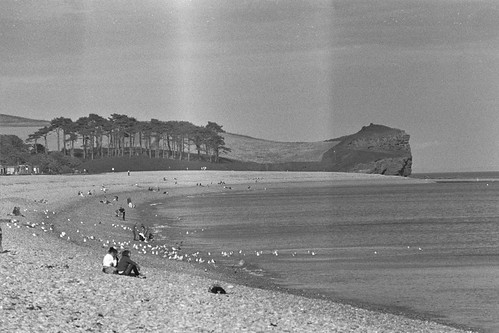

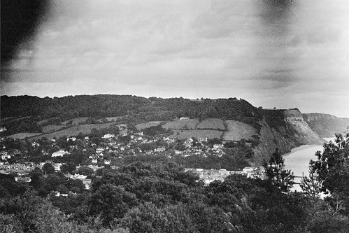

There's some odd darkening happening in some shots. It's like a light leak, but DARK not LIGHT. The top left corner is darkened, like a vignette, but then there's a tapered streak on the right hand side too. It's happened in several shots, from different rolls and different processes, and I think it only happens either at fast shutter speeds or slow apertures. Here is the problem:
http://www.flickr.com/photos/22022399@N05/4891851475/in/set-72157624601162821/
Here it is again on a different film:
http://www.flickr.com/photos/22022399@N05/4892404226/in/set-72157624601162821/

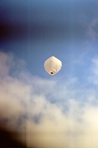

Notice the white banding too. Now have a look at this, which is from the first film and the banding is even worse:
http://www.flickr.com/photos/22022399@N05/4892459592/in/set-72157624601162821/

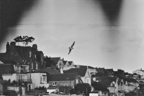

Finally, there's one shot with a different kind of banding:
http://www.flickr.com/photos/22022399@N05/4891863723/in/set-72157624601162821/

well the last one looks like a light leak ,,,,,dont know about the dark ones though,,,,and the banding on the lantern looks like some kind of roller marking ,,,maybe when being developed,?
The ones with the dark corners look like you have had one of those scalloped wide angle lens hoods on which has not been on correctly so giving the vignetting (been there done that as well)
The light ones are a bit odd and look like roller marks as donutagain suggested.

Hmm. The A1 has a cloth curtain shutter, no? Is it smooth, no creases? does it flick across the film mask properly? Are you sure? Are the two leading edges parallell and perpendicular?
As for the other marks, rollers def, most likely from the developing as the image is distorted not just scratched - so I am thinking the emulsion must have been soft at the time.
Last one's a light leak though.

A1 does have a cloth shutter, I'd definitely hazard a guess at a dragging second shutter curtain for the dark corners - if its not moving across the film smoothly it could well be causing the banding too...:shake:

It's a long time since I worked with film - but some of that banding looks like poor agitation during development - could that be the cause?

I'm still inclined toward a shutter problem.
If, as you say, it seems to exhibit itself at fast speeds, then the video just confirms that it's working fine at slow speeds - which correlates with your photos.
The timing of the second curtain becomes more critical as you wind up toward 1/1000. The A-1 is electronically controlled, but there may still be a mechanical issue.
Which also ties in with my theory ^^^ up there - at high shutter speeds, tiny variation of shutter movement speed will allow lighter/darker striations on the film.
