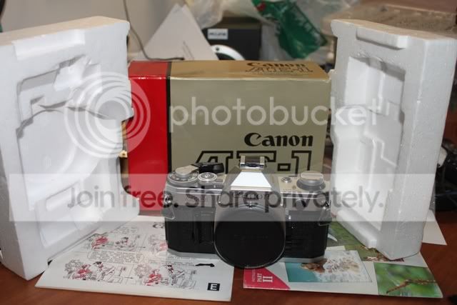

Pictures of todays new beast
And I'm assured the shutter is perfect but I will let you know next week after I've had the light seals done.
