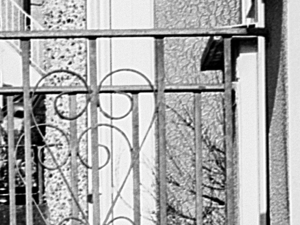

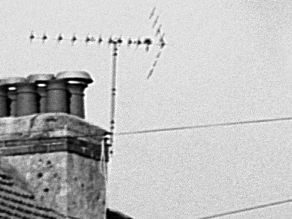

100% crops from image above :love:
100% crop chimney 6400dpi from New Camera, New Film and a Coffee by Ed Bray, on Flickr
100% crop 6400dpi from New Camera, New Film and a Coffee by Ed Bray, on Flickr
