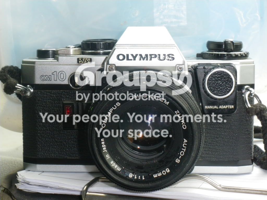

I am no expert but some kind soul on these boards informed me it takes MD lenses. They are plentiful on the Ebay although I keep losing in my attempts to win a 28mm. I am currently the winning bidder on a couple but I know I won't win!
Jacobs here in town also have some lenses pre-owned but the prices are a bit on the silly side.
thats nice. Just been lookinga t one of them at london camera exchanges website. Im thinking its top of my list atm. prices seem reasonable aswell (approx £50 with a lens of some sort)
I think I got lucky with the price tbh. To say I was happy nobody else bid after me is an understatement! It's a lovely camera, and with the 50mm attached it's nice and light.
@wallboy - how much did you get it for if you dont mind me asking?
its a good camera, i used it mainly for family shots of the kids growing up,(did i say kids growing up LOL), i will carry on using it for fun factor good luck in choosing your camera :thumbs:
