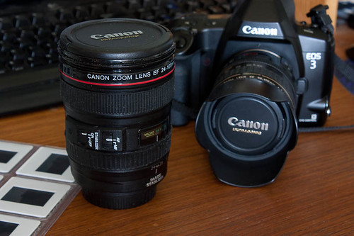

If you've got a few EF (note NOT EF-S!) lenses, then you'd not go far wrong picking up a EOS-3 body. It pretty much handles and works in the same way as the 7D - I know because I came at things from the opposite direction - I had a eos450d, bought a EOS-3 for film shooting, and pretty much stopped using the 450D unless I had to for work, because the EOS-3 made the digital feel like a fisher price toy.
The EF 24-105L is for Mugs by The Big Yin, on Flickr
The EOS-3 is pretty much bombproof, metering and AF is at least on a par with the 7D (so much for progress then!) and will alloy you to go fully manual, or any of the Av,Tv,P modes you're used to. Only problem is, it will NOT work with EF-S glass, so the kit lenses from the 7D aren't much use. If you've a nice big box of L glass though, it's more than happy to accomodate them. Expect to pay up to £140 for a decent one - they're pro-quality bodies, and hard to wear out, so if anything looks rough it WILL have had a hard life. I've a mate who used 2 of them to do the cruise ships - 10 rolls of 36 each body, 5 nights a week 48 weeks a year for over 2 years and didn't have one wrecked roll of film - approx 172,800 frames each body! And amazingly, they look pretty much like they came out of the showroom. Only telltale is the film guide backplate is a little shinier than it should be with all the miles of film that has whizzed by it :LOL: They still work nicely now, and on the occasions I borrow one, I put a tape on my camera body to ensure I don't inadvertently give the wrong one back :LOL:

I'll echo TBY here, I bought an EOS-3 to share lenses with my 20D and yes it makes the 20D feel like a toy. A couple of people have picked it up, looked at the back and commented 'oh I thought it was a 1d!' as mine is gripped making it a big heavy but very nice IMHO camera.

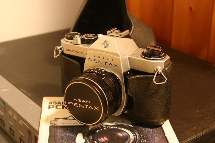

If you want something manual and don't care about using your canon lenses I would suggest a Pentax spotmatic F, they handle very nicely IMHO and use the very readily available M42 lenses, the 'F' allows open aperture metering with the appropriate SMC lenses so you dont need to stop the aperture down to meter correctly. Some of the prime lenses are absolute crackers too, my 50mm f1.4 is a better lens than the canon 50mm 1.8 IMHO and they go for about £60-80ish, you won't find (m)any nice M42 zoom lenses though so you must be prepared to shoot with primes.

anyway, my old Spotmatic F

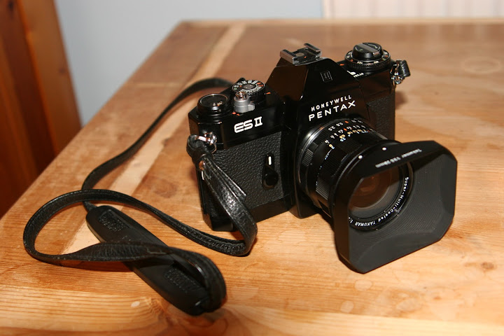

And current Pentax ESII, basically a Spotmatic F with Av mode:
I have recently aquired an olympus OM2, nice and compact but not as nice to use as the Pentax IMHO.
That ES II does look pretty nice - as I said ^^^ up there - I'm a bit of a sucker for black cameras though. I think the Practika MTL3 put me off "Panda finish" jobs - it's a wonder it didn't put me off photography altogether :LOL:

With the Pentax ES and ESII you have to be ultra careful when buying that they certainly work as the circuit board in the bottom is very prone to damage and is extremely difficult to get repaired as most repairers won't touch ES's and ESII's because their nortorious for being very difficult to repair.
