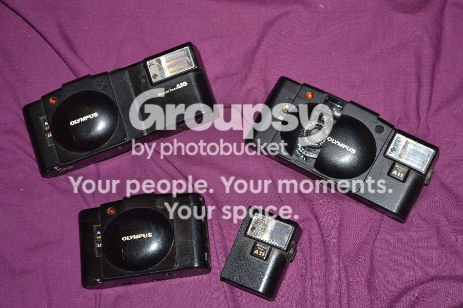

Olympus XA2... note the sliding cover over both lens AND view-finder.... also switched on the meter, so you couldn't forget to take the lens cap off! This was an award winning bit of design at the time; and the feature became obligatory on later 35mm 'compact' cameras from most makes. BUT, again, a zone-focus camera, with point and press 'ease of use'... and the XA2 was at one point as expensive as an OM10 in the shop! It ws a 'high-end' compact. I think my (first one) was £90 with flash and a film, in 1982.
