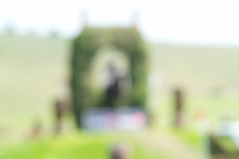

I just found one that i took last saturday showing the problem i am on about.
DSC_1061-1 by mpsphotography72, on Flickr
The exit info, if I'm reading correctly, suggests a focus point around 4.2 million kilometres away- so looks like its just a depth of field issue- stop down a bit ;-)
If the focus is moving that far out then it might be trying to relock as you're pressing the shutter. Might be worth trying back button focusing for a little while and separate the focus from the shutter to see if it goes away.

Also something i have noticed with the camera lately is when i look at the screen,the f stop just says f---,then it will come back,i am wondering if maybe its a problem with the seating of the lens to the body.
In the camera menus you set the ae lock button as the focus button so the camera will only autofocus when this is pressed. Google back button focus d3100 and there's at least one short YouTube clip showing how to set. Not near my d3100 just now to lookmt where it sits in the menu options
From your second paragraph then it might be contacts or seating though
Agree with Jim-Tod - its probably the communication between the lens and the camera

It's lens or camera then and you're probably not in warranty - unless someone gave you a long warranty?
Repair job probably - does it happen on the kit lens?
That'll tell you where the problem is
