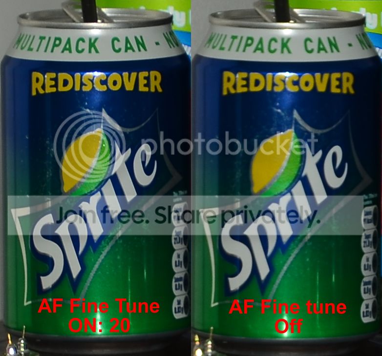

Hey Guys. A quick update.. and i am Shocked.
I decided to have a look at the issue of Back focusing.
I came across This site. http://regex.info/blog/photo-tech/focus-chart
I printed the sheets, and used the 5% sheet under my well lit room, although it is lit by 8 50watt halogens.
I focused on the black bar, and noticed the writing at the very end of the sheet was in focus showing quite a bad back focus problem.
So i messed with the AF Fine tune settings on the D7000. Set it to -20 (Maximum adjustment). It got a lot better but still off by about 5 points.
Then i took shots from around the house to see how clear the pics where.
Here is a comparison of a cropped can about 3 meters away using my 16-85 F3.5-5.6 GED Nikon lens.
My issue is it still doesn't seem to be sharp :s
Should i be worried :S
I actually feel physically sick now :s
