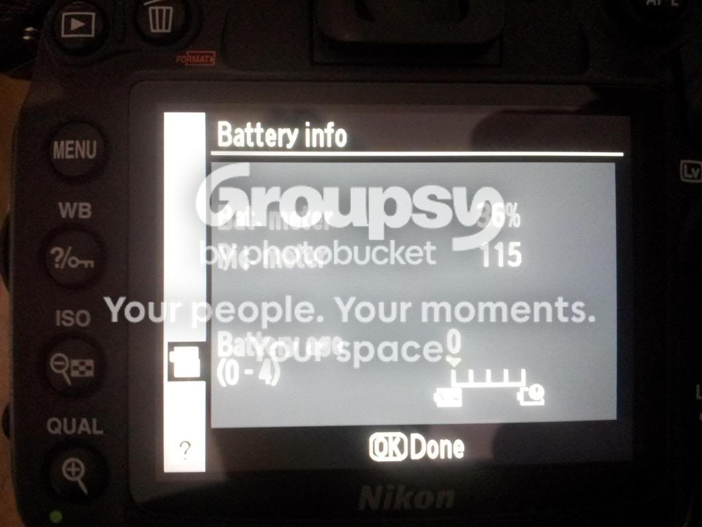

Have you checked the battery is still healthy through the menus. I had a similar issue where my camera had become extremely lethargic and unwilling to focus quickly. It turned out the batteries in the grip were nearly depleted and the camera hadnt switched to the main on board battery.
Once I had swapped battery priority in the menu the issues disappeared.
I THINK the battery is fine.
It holds charge well.
Never has problems starting up. And gives me good life with LV on most of the time and flash.
Also i store the battery outside of the camera when i dont use it for more than 3 days.
Is there a way of checking the health of the battery via camera or externally?
Somewhere in the menus it'll show battery health in a scale from 1-5, 5 being as new and 1 being knackered. The spanner icon thing is probably the best place to look for it. When I had the issue everything worked, but the buttons were a bit unresponsive and autofocus happened at a snails pace.

i checked the battery info. it shows it at zero years usage.
