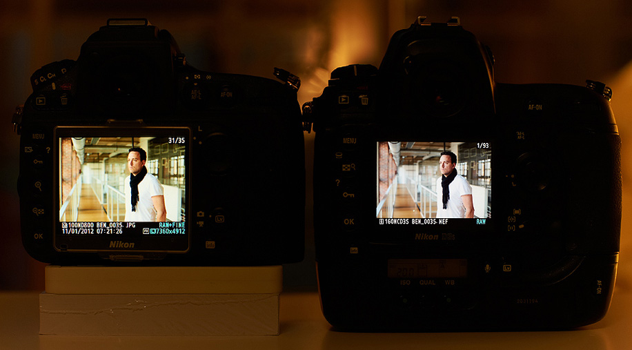

Hi all,
Well I just completed my first shoot with the d800.
It went ok and I'm happy with the camera. But I don't like the colours on the back of the LCD. Now, I realise this has probably been done to death but is their anything I can do about it? Is there a workaround or something? I know nikon said they were happy with the colours (and they may well be more accurate) but I'd like to know what others are thinking, what you would do if you share the same opinion as me.

No issues with mine, in fact I think the screen displays the best colours out of all my previous cameras
You shouldn't be judging images based on the LCD for such fine details like colour accuracy or tonality, and especially exposure. It's a crappy un-calibrated low res LCD showing a compressed JPEG preview. Ignore it. If the results are what you need when viewed in a properly colour managed environment, then that's all that matters. If you are also shooting RAW, the colour balance at capture is totally irrelevant.
Couldn't agree more. It's the difference between other crappy, low res, uncalibrated, compressed JPEGs on other Nikon camera's that struck me.
And to call it green was unfair really; "warmer" would have been a better description.
Think you may be correct, but the green is definitely there if yours is affected in the same way? (This isnt mine but credit to the OP)
I can't say I've noticed mine being green either... but I've never actually compared it to the my other camera. I only use it to check the histogram anyway.
