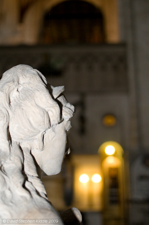

I was taking some shots today with my SB800 off camera with the on board flash as commander. The on board flash was set to -- on the camera menu but still appeared to be lighting my shots. I thought that setting the on board flash to -- would mean that the on board flash would pre-flash to instruct the off camera flash, but should not flash and contribute during the exposure?
Help anyone? Is there a setting that I need to change to get this to work correctly or is there a set of circumstances that would cause this to happen?
For info, the camera was set on manual, 1/30 @ f2.8 ISO 800 using the Nikkor 28mm AI-s. The SB800 was positioned camera right on the floor and was firing.

You example pic however does look like the on board has fired at a high output though Dave, as if on full power, which will happen if you haven't confirmed your choices correctly. That's a fact.
Thinking about it, the mail is referring to spill and not a full blown discharge. I agree the preflash may effect exposure if your close enough to the subject but not that much.
That would make sense as it would be contradictory to the instructional DVD :shrug:

This shot was done with CLS, using the onboard on the D300 to trigger the off-camera flashes
If you look just above the second N in Canon there is a highlight, I'm wondering does that look as if it came from the onboard? The flashes used to light the pic (sB800 +SB900) were on my left quite a bit back behind a shower curtain, so I can't see why there would be a highlight coming from my right...:shrug:
Good example Graham and also proves that the Nikon rep is referring to spill from a preflash and not a full blown discharge from the on board flash.
This makes more sense, although the increase to 320th baffles me as it's 1 stop higher than the camera's sync speed so the shutter will be visible in the exposure.
I'm still convinced that the example pic that Dave has posted is from incorrect confirmations within the command menu.
I don't know enough about CLS yet, Tomas. This was basically my first pic using it and to be honest I didn't feel I was getting consistant results, which in theory I should have been getting every time. Looks like I need more practice....
