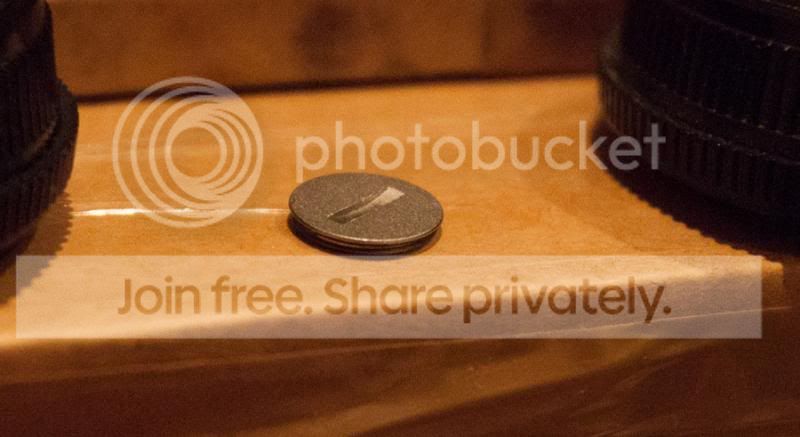

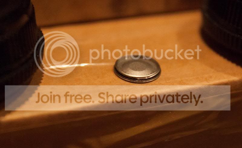

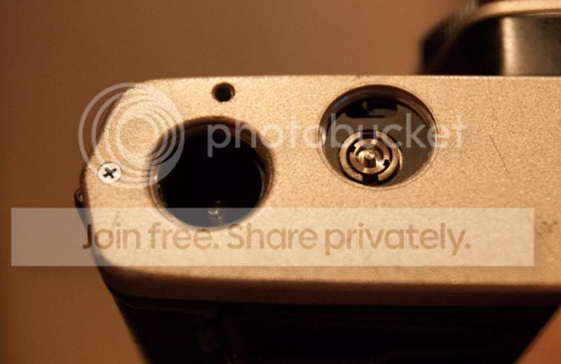

I'm sure it'll make no difference - but worth mentioning - I noticed that on the bottom of the camera, where the winder drive connects, there should be a cover, but the previous owner has lost it. The cover for the battery compartment fits this space as well, same thread. Are they actually the same covers fitted to both holes?
This is the one currently fitted to my battery compartment, is this the same as yours?
I'm guessing this isn't the original battery cover either, as it's a slightly different colour to the body...
So do your battery and winder drive covers share the same colour, size and thread?
Battery cover looks okay and you've already confirmed that it closes the circuit when screwed into place. Absence of a motor drive cover is not unusual and won't affect the electrics.
