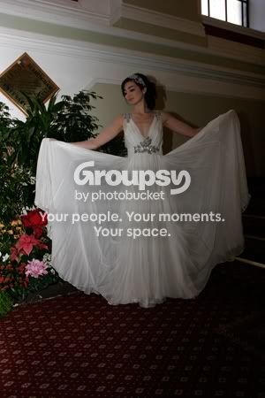

I had a bit of a on-camera flash disaster today. At the end of a wedding dress fashion show shoot they wanted a few shots on the staircase. I put the flash on my camera and looked at the high ceilings and wide apart walls.
I tried to bounce the flash on the wall to the left of the model but as you can see the result is not very good. It was all over in less than 2 minutes and spare time for thinking was in short supply.
How could I have done it better? Should I have to tried to bounce it either off the ceiling (25ft?) or one of the walls?
Would I have been better using a stofen or pointing the flash directly at the model with -3ev?

It looks like you bounced the flash on your left side ? I'd have bounced it on you right so that the flash would have more evenly lit her . Another option stofen with flash pointing up to defuse the light . I'm sure that others will have better ideas as I'm still learning too .
Flash with white things and bounce is usually a mare for me, it looks like the flash has detected the correct exposure from the light bounced back off the wall and quenched the light.
could be wrong though.....open to be put right as flash is something i really struggle with myself.

The 430 has struggled for enough power to cover the distance you have tried to bounce at at the aperture you have asked it to cover.
Don't forget when using flash your aperture controls the flash exposure. Shutter speed controls ambient.
I'll make a guess that you didn't shoot with everything on Manual?
Shooting manually, you could have opened up the aperture a little and got more power from the flash by doing so.
The best way to shoot an image like this is with some form of off camera lighting. Then you don't have the distance problems because you can place your flash where it is needed, lighting your subject. The other option is to use a video light. I keep a cheap one in my bag and it's a great little creative tool. SO much so I'm seriously considering a blooming expensive one :)

The 430 shouldn't have struggled with that tbh, i've used mine over greater distances and with less available light.
it would be nice to see the exif though.

I'm happy to recover the photo in ACR but I posted the uncorrected photo so that next time I get in right first time :) - and hopwfully minimise the harsh shadow behind the model/ get a more even exposure between the short and broad sides. (Is it broad & short lighting or short & long?).
Yes, the camera was in full manual mode. The settings were the ones I'd been using with a 60" brolly and two flashes in the main room. In the "quick, quick - to the stairs" I didn't change them :( But would f3.2, for example, have helped get a more even exposure? I'm feeling that the bounce was too close to the model. Now if I'd had an assistant they could have held a reflector besides me (behind and they'd be lower down the stairs) and bounced off that.
I hear what you're saying bouncymelons but it was a quick - go. A planned approach would have been better but it was the last 5 minutes of the day etc. Video light - I've seen Yervant uses one. Have you tried one of those LED jobbies on ebay?

Sorry, I don't know what you should have done, but I always have this problem when I shoot in portrait orientation, with a 580EX on the camera. I always get the same effect, Ok on one side, and dark on the other. I'm guessing that this is because the lighting has come from one side. I usally end up shooting in landscape, and cropping to portrait. The flash gives out a more even exposure this way. I know that's not the right thing to do, so would love to know how you can over come this. BTW, I'm no portrait photographer, it's just shots of the family etc.
I'd shoot in landscape format for a start, and then try to get large shoot through umbrella or softbox near the model, and a few reflectors. High iso, or even better - shutter dragging with some fill in light would be a neat alternative.
I can't see much bounced light in there - it's mainly direct flash, but because you've tried to bounce it half the flash has missed the target and hit the wall. Not sure it can do much from that angle though. The shadow cast behind is directly from the gun.
You'd probably have got a good exposure if you'd used E-TTL. If you want to use manual, you need to take a few test shots first - nobody is that good at guessing and flash is very critical of distance.
If you're in a wide open space, you have to provide you're own diffuser/reflector. A Stofen won't do any good - it will just blast light everywhere and nowhere. They work brilliantly with a normal ceiling, but without that, or a well positioned wall at least, they just waste light. A Lumiquest bouncer works quite well, but you need to be a bit closer for that to be significantly better than direct flash.
What you really need there is a softbox on a stand up a bit and slightly to one side. Assuming that you didn't have a softbox handy, or even time to set one up, direct flash with the gun held up and to one side on a remote cord would look better, exposure on E-TTL and if you need to moderate it, use +/- compensation. Or you could use manual but the big advantage of E-TTL is that it will adjust the exposure for you if you suddenly need to move forward a bit, then back again or whatever. Trying to keep up with exposure changes like that manually is very testing!
Edit: crossed post with Daugirdas - slow-sync flash (dragging the shutter) is a very good idea for that! If there is at least a bit of ambient going on, let it do most of the work and just add some direct flash as fill-in to lift everything and give it some punch and sparkle :thumbs:
Why landscape? I don't think I'd have got everything in the frame - I was at 17mm and it's the dress that I was photographing as much as the model.
I hear what you're saying about umbrella/ softboxes but that wasn't an option.
The flash was in eTTL (I'm 99% sure - does it say in the EXIF data?) and the was aimed at the wall to the right of the model - it wasn't pointed directly at the model. Holding the flash off-camera: that's a good idea I didn't think of at the time.
I'll have a search for Lumiquest bouncers. In retrospect, trying to use more ambient light and possibly setting -2EV on the flash would have been better.
I think I need to try to recreate the location and try a few different techniques and see which gives the best result (without using any external lighting or modifiers. Any more suggestions/ comments are more than welcomed :)

One EX430 pointing left with a diffuser fitted and a wall that is a distance away?
Don't forget inverse square law that means if you double the distance you 1/4 the light. Light falls off a lot faster than you might think. If you look at the pic, the light is just hitting the left of the model but has gone by the time you get to the right. That's a fairly classic light fall off pattern and I would guess that it comes from shooting at f5.6 with a diffuser where you already lose a stop and a wall that's too far to effectively bounce the amount of light back effectively. Bouncing loses you a stop or two as well because not all the light is reflected or reflected in the right direction. Add it all up and you probably lost about 4 stops by trying to bounce a diffused flash off a wall too far away.
Getting the flash off camera is the answer :) Even if you don't have time to rig a softbox, a voice activated light stand (any other human you can coerce!) with the stofen fitted would have done a job :thumbs:

Bounce cards are great, but only if you have a ceiling to work with and one that is 25ft high or whatever in that situation is effectively no ceiling at all. Stofen works in exactly the same way, but squirts light out of the sides and back also - brilliant in a small room but the bigger the venue, the less use they are. If you use one outside for example they will do absolutely nothing more than direct flash, other than blast most of the light into nowhere.
Holding the camera in landscape mode, as suggested earlier, would prevent that big shadow being projected behind the model since the flash is in the hot-shoe. The inevitable shadows created with direct flash look much better if the flash is directly above the lens.
Maybe a flash bracket, one of the rotating ones?
You might have tried to bounce, but the flash was still pointing at her a little which caused the shadows. Looking at the corner in the carpet was there a wall behind you ? Point the flash behind you and up a little, instant softbox behind your head.

I was stood at the top of a staircase so the "wall" besides me disappeared as the stairs descended, with nothing at my head height and the closest wall to my left or right was possibly about 15ft away and was staircase railings. Thankfully the shot wasn't a "I must have this photo" but I would like to have a few ideas to try next time.
Would a bounce card with a hood (there's a thread on them on POTN) have helped shape the light at all, in a useful way?

Do you mean like a Lumiquest, like this? http://www.warehouseexpress.com/buy-lumiquest-quik-bounce/p1031217 I use one of these, it does everything pretty well and helps a bit regardless of whether you have a ceiling to work with - fill or bounce/fill - and can be orientated in all sorts of different ways. Very handy and versatile :thumbs:
With the flaps closed, it softens the light usefully as short range. But as distance increases the light gets relatively smaller compared to the subject and for your shot it wouldn't have made a huge difference. Better than direct flash, but not a transformation.
If you want to soften the light and reduce the shadows, you just have to make the light source bigger - usually a lot bigger. That's how softboxes and brollies work. With lighting attachments, the size of the light reduces, relative to the subject, quite quickly with distance.
For that reason, bouncing off a ceiling or wall is favourite - instant huge softbox. But the light is of course then coming all from above which casts shadows under chins and eyes so if you can then add a bit of fill-in as well you get a very nicely balanced result. The fill-in lightens faces and puts a sparkle in the eyes, plus the bounce off the ceiling spreads nice soft light over a wide area. Needs a fair bit of flash power though.
It's an 'I need a deeper bag of tricks' moment, the biggest thing I try and work on, deepening that bag :D

Thinking about it I probably should have asked her to stand in the dog-leg part of the stairs (above the corner) so I could have bounced the flash off the wall behind & above me. Clearly I need to be more alert to opportunities and not accept what I see (or where the model decided to stand).

Here's one from the fashion show, taken using a 60" umbrella with a 430ex and a Vivitar 3700, behind my right shoulder:
I'm wondering whether having the umbrella a little lower would have reduced the shadow under the chin?
That's better! You can hardly tell any flash has been used there - looks like a nice big window. There's also a lot of ambient light in there helping to fil-in and soften.
I wouldn't move the light at all. As a general rule, don't move the main key light below eye level as it just look unnatural. Can be very effective, but unnatural.

Any particular reason you shot at f/5.6 instead of f/2.8, or 1/125 rather than 1/60, or 800 ISO rather than 1600? You have really pulled in no ambient light at all. The flash is doing everything, and with that large expanse of white it has probably quenched early, unless you dialed in some +ve FEC. Also, given relative distances and placements, it does look like bouncing to the left was a poor option. Pulling in more ambient would have eased the problem. You could have raised ambient exposure by 4 stops in total, with different settings, leaving the flash with only a little work to do.
I routinely shoot indoor evening stuff at 1/60, f/2.8, 1600 ISO, with bounced flash, and the results turn out well, and sufficiently low in noise, even with a 30D. Here's an example with no edits....
Good advice Tim. This recipe works well for me 1/80 sec, ISO 800, F2, Flash at half power (or less).
