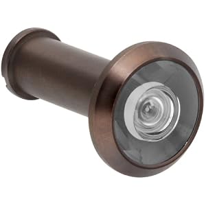

Back then I made a fish eye lens from a door lens (like below) and a lens cap. And it fitted on the front of my 50mm standard lens. It gave a circular image with a black surround, but yielded a lot of fun images as slides.
