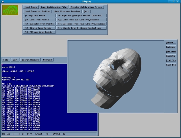

If you have stereo pairs of images, or images taken from known positions, there is software that can align matched points and manually selected points to generate a 3D polygon mesh. You could then take measurements from that or reverse project a grid on the original pictures. If you do have stereo pairs and you need to do lots of measurements this will save a lot of time.
I'm on my phone so I only did a quick searches . But it is worth a full search for "stereo photo metrology" .
Free software http://stereo.sourceforge.net/
https://www.physicsforums.com/threads/creating-3d-coordinates-from-stereoscopic-images.761925/
