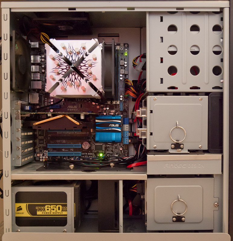

I'm just happy there's no blue screen of death and I have to give a lot of thanks to these guys as their videos helped a lot, especially with my confidence. The motherboard manual was excellent and easy to follow and you can take both sides of the case off so that's good for cable management - there's space there as well! There's an extra 4 connectors on the MB for fans so I only had to connect one fan directly to the PSU. It looks like the MB can control these fans, or monitor them at least, which is good.
There were only a few issues:
1. There's no way in hell you can get a fan on the bottom of the case as the PSU covers a fair portion of it, even a smaller PSU would obstruct it I reckon. I'm glad I didn't buy a fan for this bit.
2. The top fan nearer the rear presses against a heatsink that is built into the motherboard - it's only just touching and not massively keen on that but I installed the fan anyway.
3. The window on the side of the case does not support a 140mm fan but online it says it does (perhaps a bad review). Had to drill some new holes so no big deal.
I think the case is being a little optimistic with the amount of fans or the placement points of them isn't too good - a bigger case may have been better for me as I like lot of space. There's plenty of room on the other side though where the harddrives are.
The biggest annoyance was the PSU because of the plug but again easy solved. I've read online of people using a 2 pin adapter (like you use for shaving) but the fuse is like 1amp in these so I wasn't keen and just used my old supply instead.

Ok, not the best build photos but it was a long late night and there'll always be much better out there on the net anyway. I ended up stopping the photos near the end as I lost the will to live with cable management.
