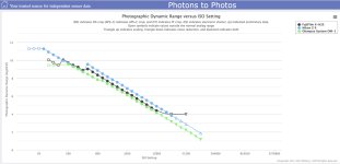

OK, so here's a snapshot from the website comparing 3 bodies. 2 I own and one I don't (the Fuji). If we look at for instance ISO6400, it states that at this ISO, the OM-1 has a PDR (photographic dynamic range) of 5.12, the Fuji X-H2S of 5.38 and the Nikon Z9 of 5.86. That's less than 13% difference between the M4/3 and FF bodies.
I can't imagine in the real world that the difference in high ISO performance is that small (at least to my eyes when comparing the OM-1 to the Z9) ? It is to do with resolution as obviously the OM-1 has 20mp, the Fuji 26mp and the Nikon 45mp ? It's not that I'm looking to change or add another body, I'm just trying to understand using this site how you compare one body against another ?

So what this says is that at ISO200, all of the cameras have a useable dynamic range of just under 10 stops, before noise overwhelms everything else in the darkest part of the image? And at ISO12800 this range is only just above 4 stops, before noise overwhelms everything? Is that correct? I'm thinking an image shot at really high ISO wouldn't have that much DR anyway, as by definition it would be quite dark?

Yes... noise limits the minimum (darks) and amplification (ISO) limits the max. Even if the scene at ISO 12,800 did have a greater DR, the highlights would all be pushed into ADC clipping due to the ISO amplification.

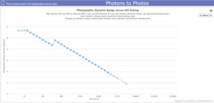

@sk66 would you mind advising me which charts on photos to photos are ones which are going to be more meaningful for real world images please, Photographic DR vs Photographic DR Shadow improvement and then read noise in DNs vs input referred read noise?
Sure...
The photographic DR chart only shows you the useful DR capability of a camera at a given ISO. It is really only useful if deciding between cameras... and to know/show that DR necessarily decreases as ISO is increased (i.e. highlights are pushed into clipping).

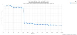

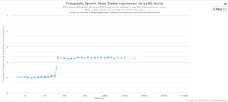

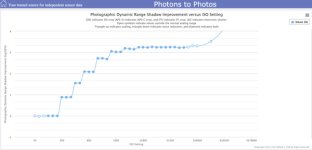

The DR shadow improvement chart shows what benefit there is to increasing the ISO...i.e. how ISO invariant a camera is. And if a camera is dual gain, where the sensitivity change is. E.g. this chart for the Z9 shows that for anything below ISO 500 I could just use ISO 64 instead, and anything above 500 I could just use 500 instead; there is about zero reason to ever clip highlights with ISO amplification. Note that this comparison (changes/increases) is only in relation to that camera itself (native/base ISO always starts at 0).

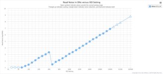

Read noise in DN's will probably make more sense... noise increases as ISO increases (except for the dual gain/increased sensitivity step).
This is the voltage (electrons) the ADC is getting at each ISO to generate the image/noise... it is basically the DR shadow chart inverted.
Do not get overly wrapped up about the noise charts... it is only sensor read noise, it is not "image noise;" it's not even based on an image (it's measured from masked/optical black pixels). The primary factor in image noise with modern cameras is photon shot noise, which is scene dependent. Also note that the noise charts specifically say that they are not useful for directly comparing between different sensor sizes.
