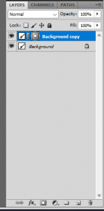

Not used this programme for a very long time as I am only just getting back into my photography. I have been watching a few utube videos on starting up again with layer masks.
Now my layer mask looks nothing like the ones I have watched, which are all plain white, mine has a circle in it. Tried all the setting but no good.
What do I need to do to sort this please. All help appreciated.

I think that's just the way the later mask symbol looks in your version. Over the years the interface of PS has changed. I'm assuming the mask still functions?
So the mask layer you have chosen is a pixel mask, you could have chosen a vector mask. That is the default icon for a pixel mask, it will stay like that until you use a tool to create pixels on that layer like a brush tool for example.
To make it easier to see how layers interact I would double click the background layer in the layers pallet to unlock it and fill it with a colour. Then fill the layer mask above with a different colour. It will make it easier to see how the layers interact.
In addition, on the top menu choose view and select the masks pallet, it will then appear next to the layer/channel/paths tabs you then have quick access to the various options available with masks.

I don’t have CS5 so the process might be slightly different.
Click on the Hamburger icon (series of lines) top right of the layers panel. Then from the menu select Panel Options, and then select the size of thumbnail you want to use. Then click OK.
Just did what you said Eucris and bingo, brilliant thankyou. So it was not the default mask. Looks like it should do now. Happy boy.

I still use CS5 with no issues, (Touch Wood). Mine is the same setup as yours I personally don't really need images showing, but as Eucris suggests, with panel options will bring the image and size into play..
