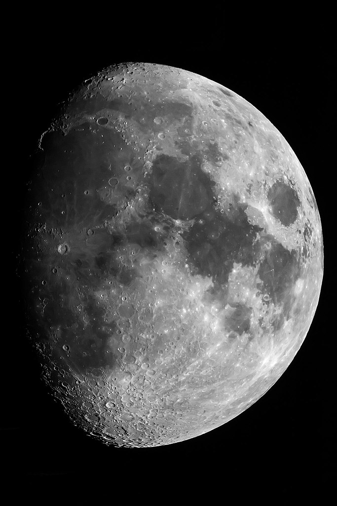

I have this portrait image of the Moon which I want to "Cut" out and paste into the middle of black landscape canvas, keeping the moon upright in the process.
What's the easiest way to do this?

I think the simple canvas re-sizing trick will work. I just tried it with the image posted here and there's no fringing.

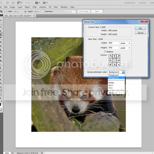

The "canvas size" option is the easiest and you can set the background to colour to what ever you want.
Make it white, if you like, then the pick tool, to get the exact match on the background colour,
and use the bucket tool to flood fill.
Image (top left)then Canvas size, from the drop down menu
I started with a 600px image, then set the canvas size to 800px.
You can see the colour options below.
If you don't want it square, then just alter the appropriate height / size in the "boxes"
