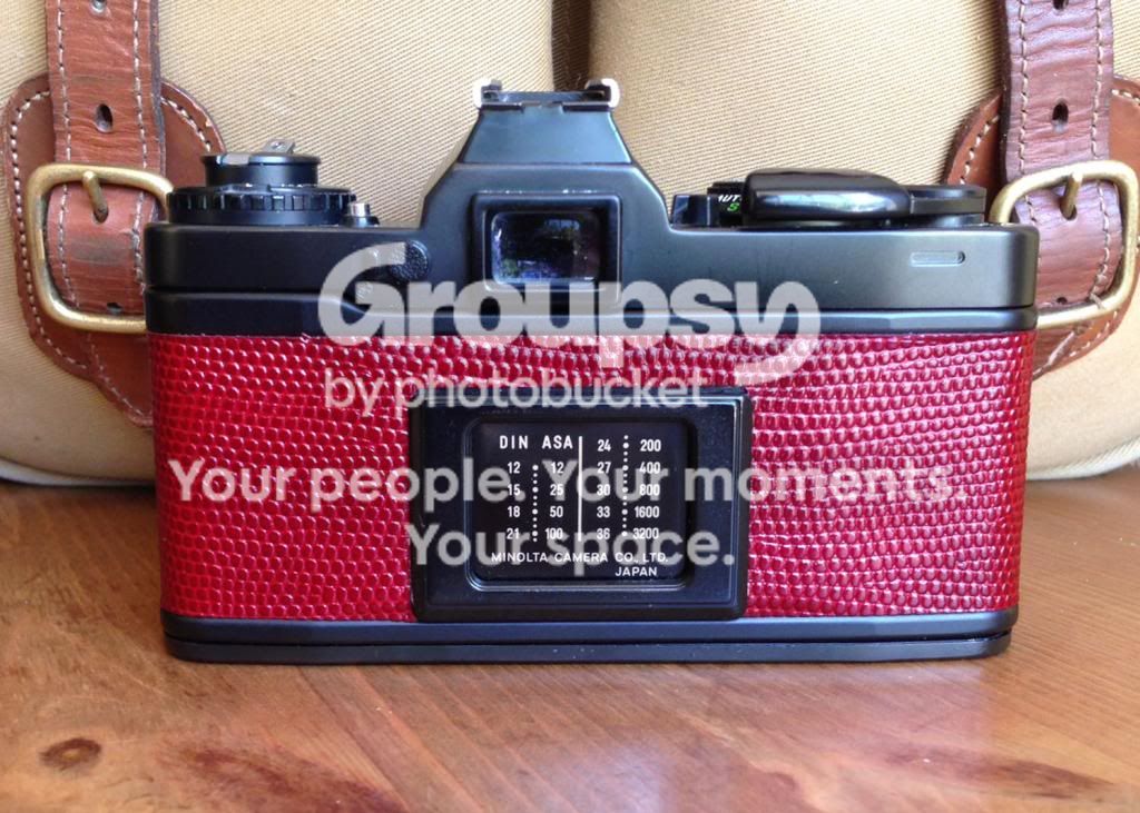

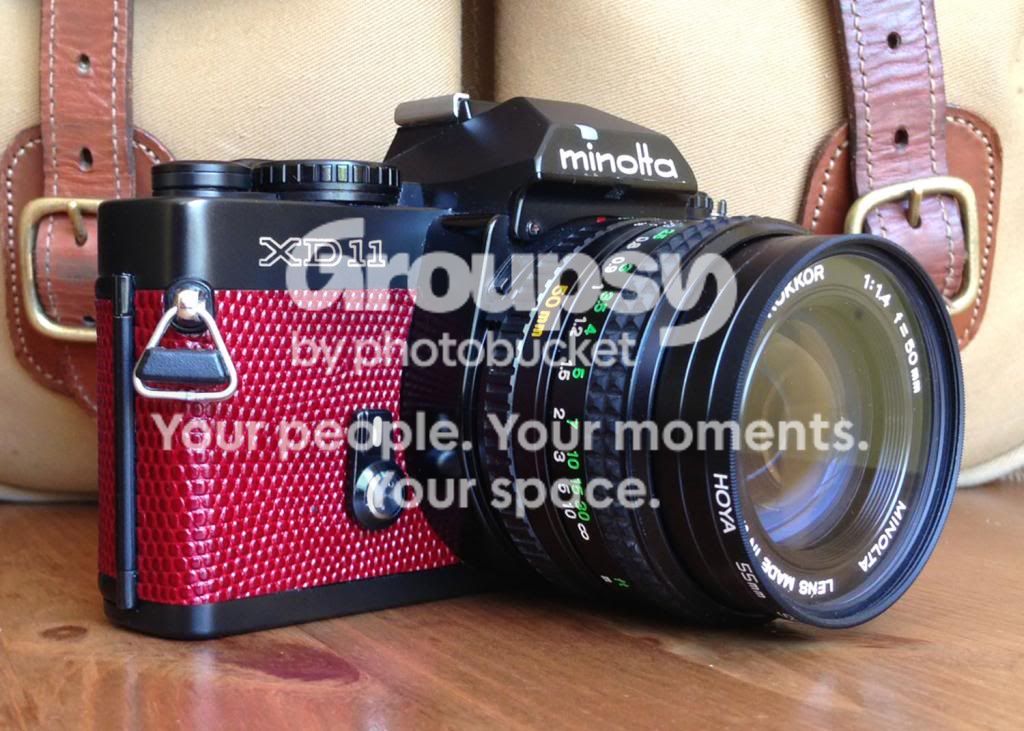

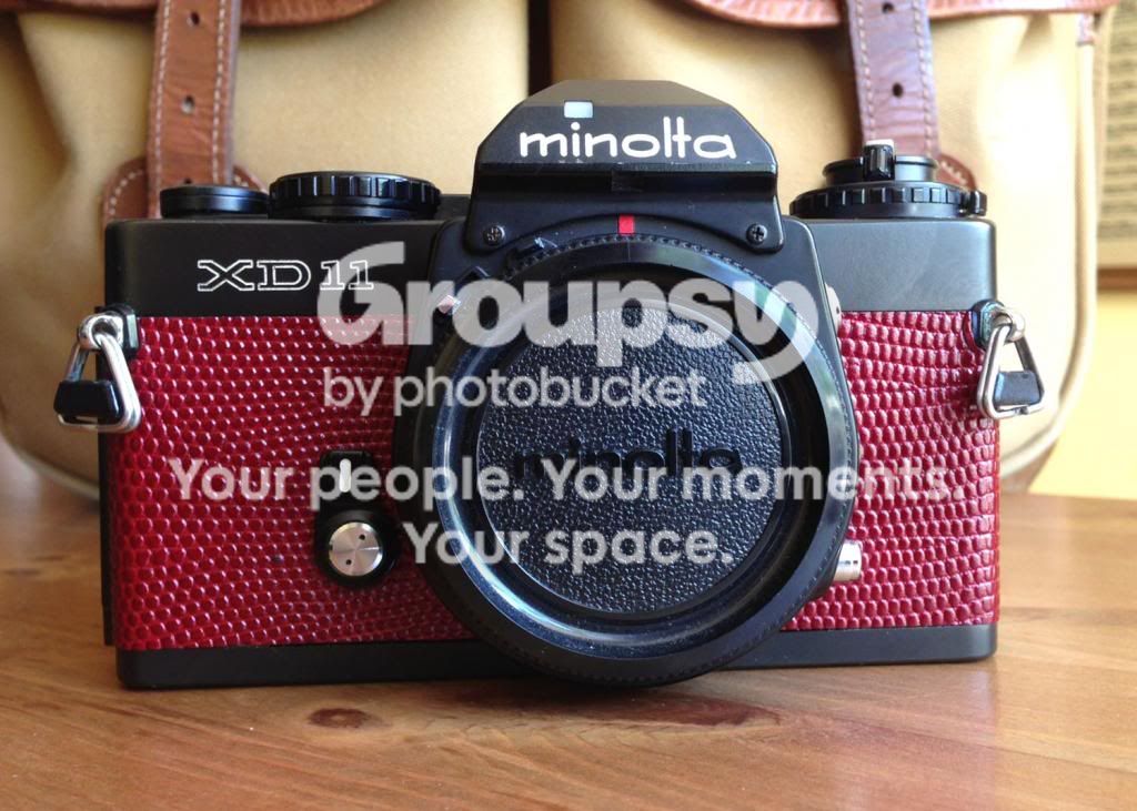

Just refurbished my XD11. This was my father's camera which he bought new when they first came out in the late seventies. I have used it for some ten years and now my son is starting to use it so I put a new covering on it for him yesteday. He hasn't seen it yet. It's actually a little more burgundy than these photos suggest;
