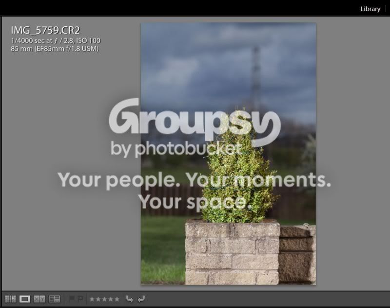

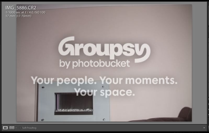

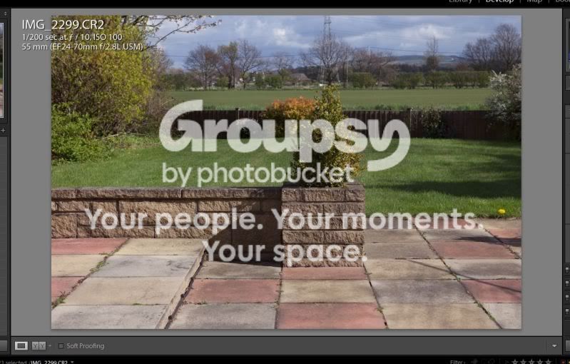

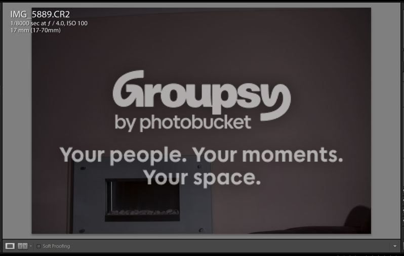

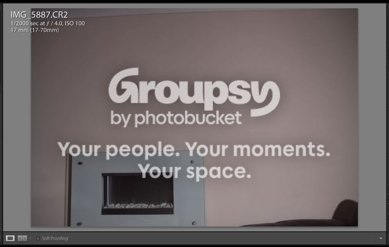

Pixel King Hypersync Results!!!
Thanks for the comments guys, with regard to the power settings Garry, i'm fairly sure I have it correct, at power 5.0 Channel A should be giving 800ws, for each 10 clicks down on the scale is 1 stop less output on the meter, so Surley this would be half the w/s..? making 4.0- 400ws and 3.0- 200ws, 2.0 - 100ws, 1.0 - 50ws
or am I missing something.:(:(
I just double checked with my meter to make sure I wasn't dreaming this...haha
Strobe bounced up to the ceiling with Sekonic Meter on my desk....
socket A only
1.0 - F5.6
2.0 - F8
3.0 - F11
4.0 - F16
5.0 - F22
Channel A+B
5.0 - F29
