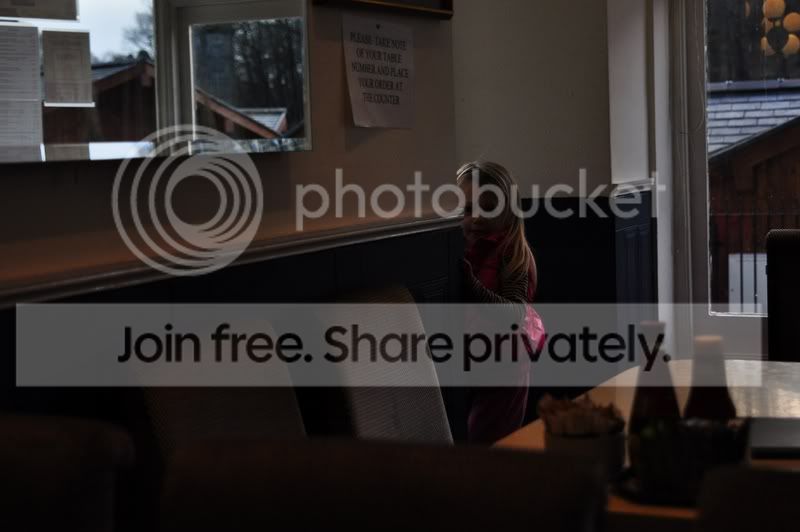

The gist of the problem is that using A mode (which often do) or P mode (occasional) the camera seemed to be choosing ridiculously fast speeds...far too quick to let enough light in, noticably so indoors without flash. I like to shoot F2.8 indoors and let the camera chose the speed / iso and would normally expect 1/30 or 1/40 but the D90 was wanting to shoot much quicker giving underexposed results.
Here's some examples (excuse the crap pics - I was just collecting examples of the problem) :-

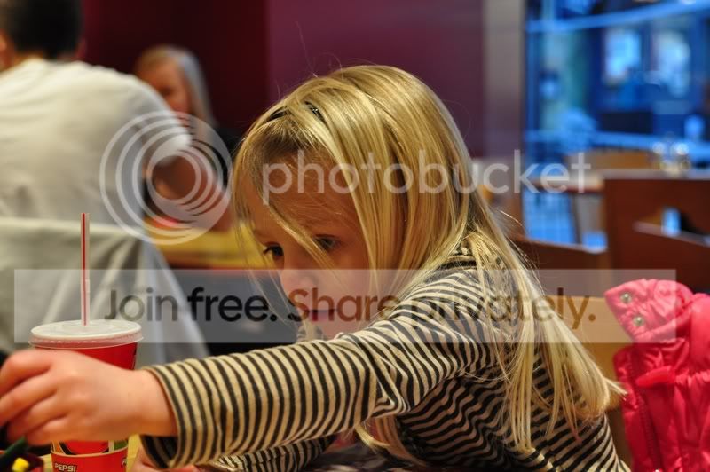

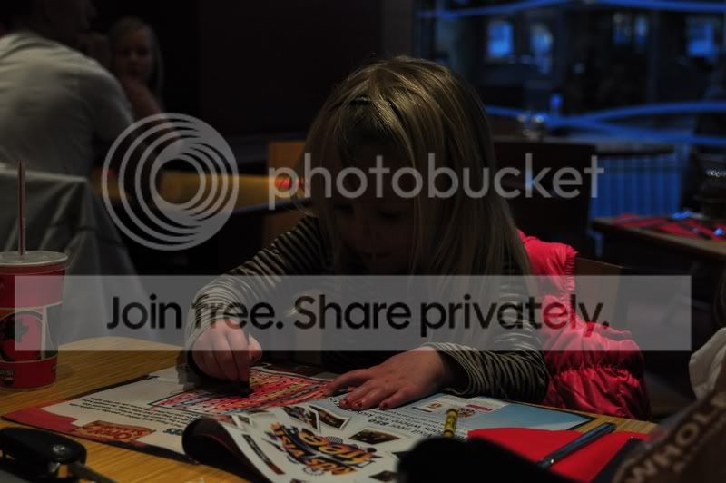

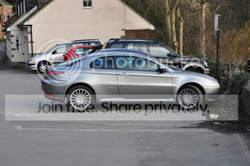

A mode F2.8 - Camera selected 1/4000th....far too dark
Tried again this time it choose 1/100th but focus appears to have locked on the bldgs behind

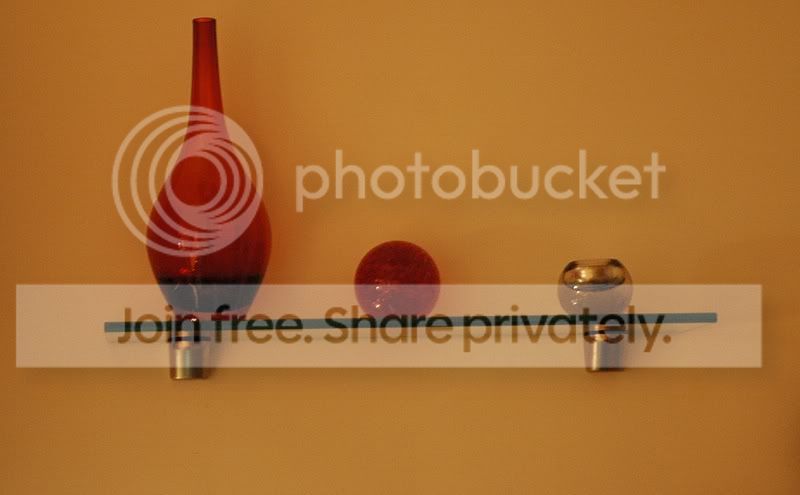

Indoors set to A mode F4...bit soft but lighting is correct...camera used 1/50th which is as i'd expect
Tried again this time it somehow decided I needed 1/400th !!

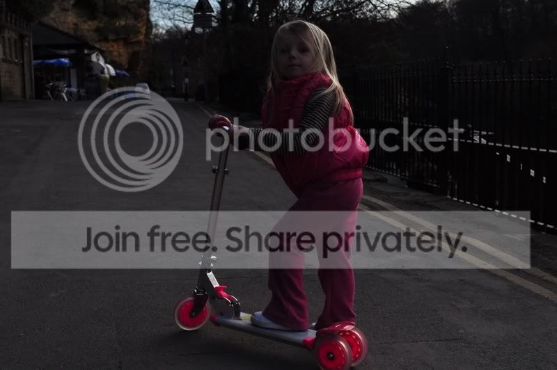

Another at F3.2 in A mode - camera decided it needs 1/2000th !!

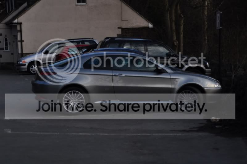

Outdoors at F5 - again opts for 1/4000th

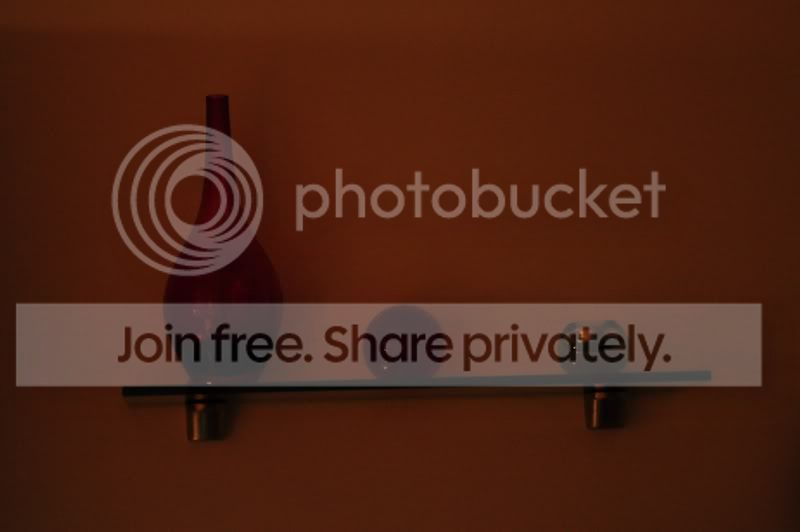

Indoors at F2.8 in a darkish area....pretty much on the money light wise by the D70
Again the D90 is way off with the same lighting and lens :-
