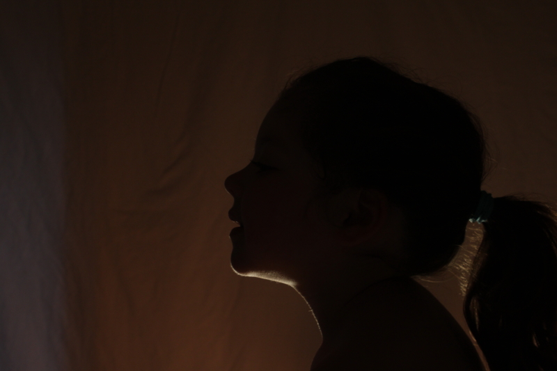

First of all I want advice on my silhouette – I’m working through 71 projects in my John Hedgecoe book, and the first involved shape – 1) produce a silhouette and 2) a series of shots in which the focus is shape. I did manage to produce a silhouette but why is the background so dark? Should I have aimed the light at the wall rather than my daughter? (it is directly behind her). Or used a higher ISO? (I don’t have the original files here but I think it was ISO 400). Actually you can hardly see the silhouette on my screen at work, it was much clearer on my home PC screen :-(

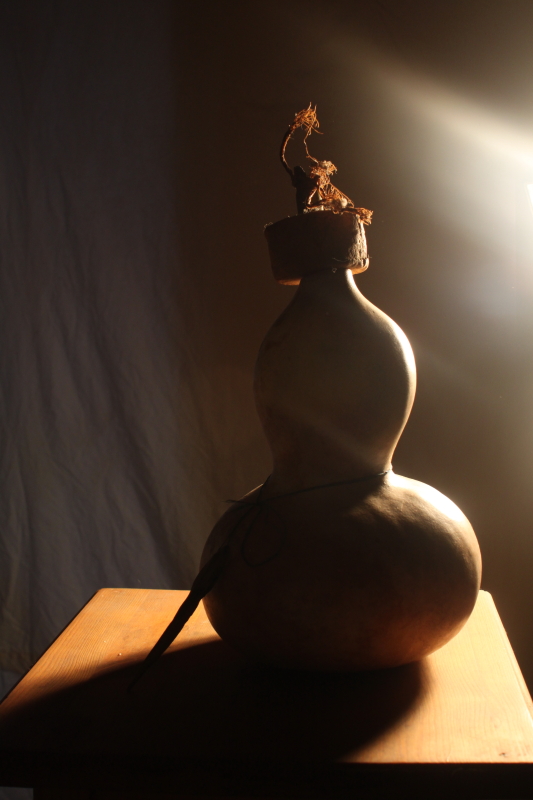

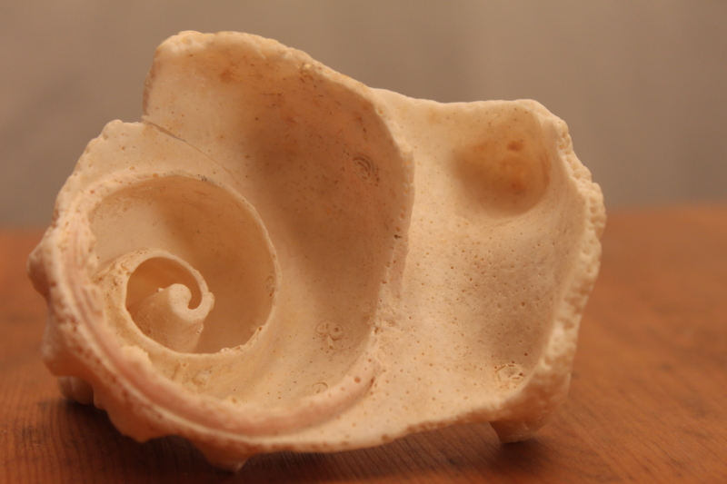

I also had to produce a series of photos focussing on shape – again they are very dark, ISO was still 400 – I seem to recall aperture was small too, 5.6 and shutter speed as low as I could go without tripod (which I don’t have yet):

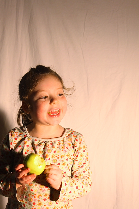

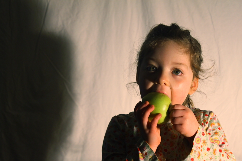

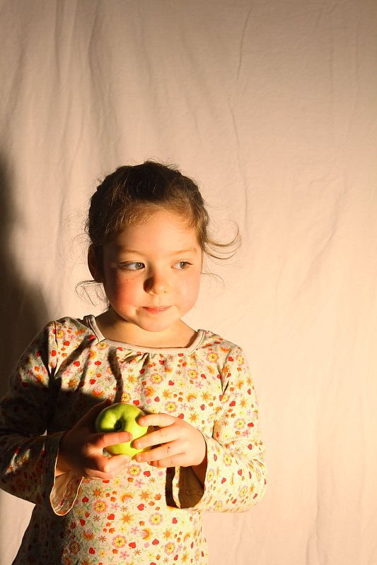

Now I took the opportunity to try and snap a few of Laura. ISO 400, aperture and shutter as for above. This is where I learnt something about lighting – I had the light slightly to one side of her and in many of the shots she has a very dark shadow on one side of her face – so, to rectify this, do I need to have a strong light on each side of her? I thought it was always meant to be more flattering to light a human subject from the side rather than straight on? Also would an additional light eliminate the hard shadow on the backdrop? I know I also have problems with the tones – too orangey despite editing, and also too MUCH shadow in general? Not nice and bright as more accomplished shots of people? (see next post down):

Silhouettes - light the background only.
Picture of vase or whatever - you have flare in the shot, caused by light hitting the lens.
Colour temperature - shoot raw, include a grey or black target in a setup shot and use that to get the colour right, or set your camera to 'Tungsten' or, if you camera will allow it, to around 2900k (in theory your halogen lamps are around 3200k but in reality it will be lower unless you have your own private power station

Lights are not bad on these (but not brilliant either!) - but the WB is - and they need cropped - keep the lighting simple and you'll be fine.

thanks AWP - I realised I hadn't cropped them :-0 I think I know a few things I can do to help white balance next time. When editing in DPP it was impossible to improve the WB - it was either this orangey, or bluey? I did alter them a bit though :-) Glad you think the lighting is not too bad - the creases are my bugbear!
DPP will sort it :thumbs:
If you shot in raw you can use the presets, colour temperature slider or the dropper on the RAW tab of the tool. First try the presets. If none get close then aim the dropper at something on the shot that you know was white and it will adjust the balance to something close. The ideal reference source is a calibrated 18% grey card (I got an A4 one from jessops for a few £) as most "white" objects turn out to be not as white as you think either because of discolouration of the material or they are reflecting coloured light from another surface. If you cant get it just so with presets or dropper then go for the temperature slider. TWith a photo taken in raw you also get the option of playing with individual colour curves on the RGB tab . . .
If you shot in jpeg then you get only the RGB tab, but a colour correction is not difficult if you have a reference point to use the dropper on (you can then manually adjust the 3 curves individually). Otherwise you can dive straight in & play with the 3 colour curves, just select the each colour and drag them away from the diagonal line a fraction so it forms a curve. Easier to play with it and see the effect than to describe it. Start with just easing the centre of the diagonal a fraction to make a simple bow. After a few tries you'll find you can tune the colouration for the darker and lighter areas of the photo by making the curves more curvy. Only takes a little bit, lots makes it go psychadelic
Its helpful if you don't mix too many types of light source in the shot as they produce different white balance. So try not to mix tungsten / halogen / fluorescent / daylight. Flash is pretty close to daylight.
