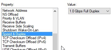

Speed Duplex
Ethernet Card Speed

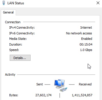

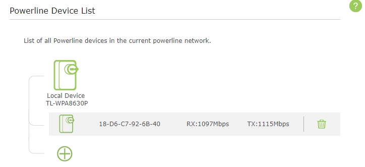

Powerline Link Rate Achieved

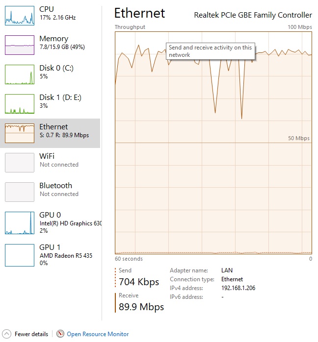

LAN Throughput at Desktop
