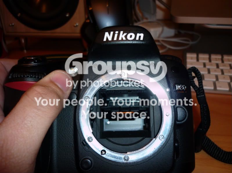

Hi,
It would appear that my Nikon D80 has died today. I was using at and the controls on the camera stopped working. After a short while they started working. About 2 hours later the batter instantly appeared to drain. It now looks like the mirror has locked half up half down (See picture).
I have tried putting in a fresh battery and there is now ERR showing on the status screen and the battery is showing as completely drain. Does anybody have any ideas if this problem is fixable or is the camera fit for the bin?
Thanks in advance for any help/advice.
ADam

Hi there is an err message on screen. Did not use mirror lock up and pressing the shutter does nothing even a fresh battery is showing as empty on the camera (flashing 1 bar). I was using the supplied kit lens and it had not been off the camera all day

Hi, Just a bit of an update on this. The camera is working again. It looks like there was a problem with the battery/grip not reporting the power levels correctly. I guess the battery went flat whilst the shutter was in operation and this caused the mirror to lock.
I was going to replace the camera and figured that I had better give it another go before going out to get something else and lo and behold it was working. Will keep an eye on it and see if I have any more problems. I don’t know why the errors were cleared after this period of time as I tried new batteries etc at the time. It would be nice if all problems could be fixed by leaving them for a few months :lol:
