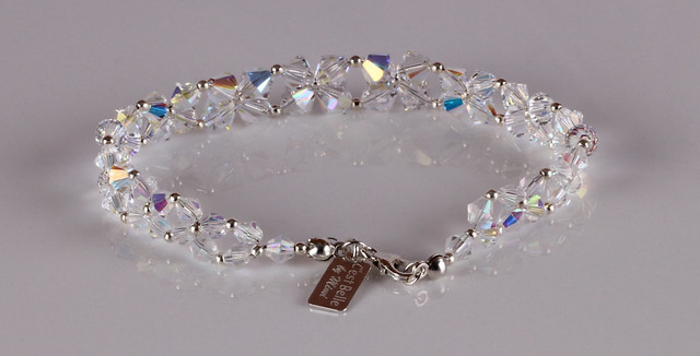

Thanks for all the advice well ive taken on board what some of you said and here are a few test shots, didnt have time to experiment so they are rushed as ive got to go to work tonight :(
All ive done is crop and adjusted the blacks using level in PS
ive also included a pull back shot of the setup

This i something ive been meaning to have a go at, i think you've made a good start but they don't look quite excuse the term "bling" enough.
Might be how far the blacks have been pushed? or slight underexposure? i would also try moving the flashgun snoot around to camera right, to see if it makes any improvements in the highlights? just an idea, it could be a crap one mind lol
I think the black glass acrylic idea garry suggested is a great point too.

Like a said it was all done a little rushed including the adjustments as wanted to get them online and posted before I went to work, (on my phone now )... I've taken Garry's advice and ordered a A4 piece of 3mm black acrylic off eBay only a few quid so gonna give that a whirl when it arrives... My main reason for getting them up was for tips and pointers on how to set the lights up?
Where to start...
I think the problem that jumps out here is the arrangement of the piece. As I said earlier, easy enough to overcome with heads and similar props, but at the moment it's difficult to see past the sort of scrunched up look.
I'm glad that you've ordered a piece of black acrylic, that background you're using seems to have a textured, absorbent material - totally wrong, it soaks up light and acts as a light absorber, and is responsible for all those areas of deep shadow with no detail. As a result (and exaggerating for the sake of effect) everything is either white or black with nothing in between -
Camera height - think about where it needs to be to show the item at its best, not just where it is convenient to have it.
Lighting - dependent on subject and on the effect you want to achieve, but basically you're close to a starting point here...
You need a larger softbox and you should fit it to your SmartFlash, as I suggested before. It needs to go BEHIND your subject, not in front as in your setup shot, so that it is pointing downwards and slightly forwards. And it needs to be closer, especially with shiny subjects. See the Lencarta lighting blog entry I linked to.
Your hotshoe flash shouldn't be at that angle. You will need to experiment, but a starting point might be much further to the right.
Your 5-in-1 reflector is a very useful tool, but it's doing virtually nothing where it is. It can only reflect light that's reaching it, and hardly any is. Mind you, it will do something when you move the hotshoe flash. But the reflector needs to be much closer, just out of shot in fact. Where it is, the light (from the hotshoe flash, when the light is actually reaching it) has to travel far too far from the subject to the reflector and back again, and the inverse square law means that it has lost nearly all of its power by then. If you add in the fact that the reflector is only about 70% efficient, you can see why you need to move it very close.
Try those suggestions and come back with some more examples - you'll get there:)

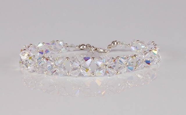

a quick go with some of the wife's bracelets. It is harder than it looks, to get the faceted crystals to look anything like they should.

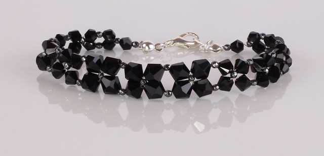

Been playing again, I had ago using black acrylic this time and a slightly different set up. ignore the labels as i will remove them when once im happy with the lighting/set up

You're getting somewhere near. Where the blackglass is photographing as grey instead of black, it's because the camera angle is wrong and you're picking up the softbox reflected in the blackglass. The correct angle is of course a combination of the angle of the softbox as well as the camera, and it's pretty critical.
Your hotshoe flashgun is far too high, and it needs to be at maybe 45 degrees rather than something nearer to 90 degrees - not sure about that, trial and error is your friend here.

That's where I must be going wrong as every shot had the reflection of the soft box in, covering the the whole lot, so I just adjusted the blacks in PP, I'd find it difficult to not get the reflection to be honest I'd have to have the large softbox some distance away to achieve this what sort of aperture would recommend I'm using around f16/f18 it varies depending on the size of the subject otherwise it's not all in focus, but worry if I move the SB to far away it just won't have the power at high apertures
I don't think you should be getting the softbox far away. It's job is to light evenly (as far as I understand). With the modelling light on, move your head up and down - you will see the reflection of the softbox move as you move up and down. You need to place the camera so it is not in the line of reflection - or move the softbox such that the reflections are not in the line of where you want the camera. You may be surprised and you probably want the softbox as close as you can get it without being in the picture (I think Garry said that in an earlier reply).
I wouldn't worry about diffraction softening. You're going to shrink these images for web use so you'll have resampled any diffraction effects out of the picture by the time you get them web sized.
Try focus stacking images shot using the best range of your lens.
Crikey... focus stacking and product photography sounds like a recipie for hours post processing at the computer. If you are doing any reasonable number, the thing you want to minimise is post time... Get a setup that works to get it right in camera (IMHO of course ;))
You can try moving the softbox to camera right a bit more to avoid it reflecting in the perspex. Also, not sure if you are using one already but try a polarising filter, this way you can adjust how much reflection you get. As the shots are for a website and presumably will be fairly small you can afford to pull the camera back to achieve deeper DOF and then just crop into the image.
This is a lighting problem, pure and simple, and it needs to be tackled as such - don't go off at a tangent!
Don't move the softbox further away, it won't help, in fact it will make matters worse. Just play with the angle until you lose that reflection. It can be done, I do it every day...
Don't adjust the blacks, get it right in the camera. Adjusting the blacks is adding to your problem, not curing it.
I'm going to sound like a dinosaur here (and maybe I am) but people starting out would be much better off shooting on film than digital, and not using a computer to 'cure' faults that are caused by lack of knowledge and lack of care. For now, forget about 'improving' your shots on computer because you're not improving them, you're rescuing them!
As I said, just angle the softbox so that you don't get the reflection.
Then position your key light (in your case the hotshoe flash) until you're getting the effect you want.
Then adjust the exposure between the two lights until it looks right
Then add the reflector, and position it to give the effect you want. Moving it forwards or backwards just a little bit will make a huge difference.
Place both your camera and your lighting where it does the best job, not where it's easiest for you.
Job done.
