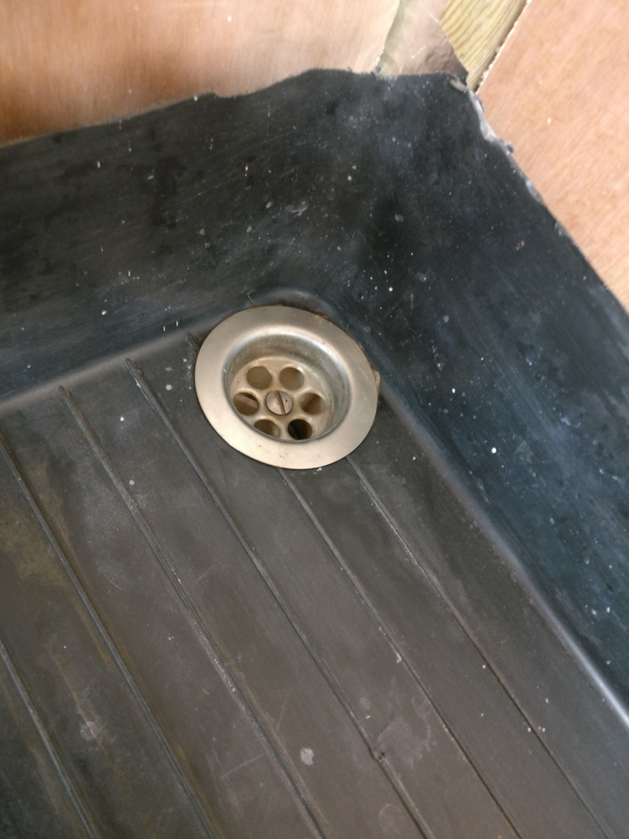

This is the setup I use, a semi-mobile unit that does the job and the sink part only cost £24 ;)
Table made from some left over C16 timber and plywood, the sink is a gardening tray 1mx1m:
https://www.amazon.co.uk/Garland-GP112B-1m-Square-Tray/dp/B004WY1QIU/
With a drain hole cut and fit with a waste fitting from B&Q.

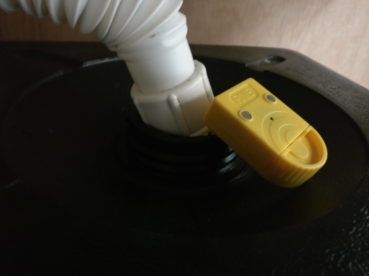

Less relevant if you've got drainage, the waste then drains into a container with an electric alarm telling me when the water level gets high:
https://www.amazon.co.uk/NRS-Healthcare-Liquid-Indicator-Eligible/dp/B006H4RDHG/
(Normally used by visually impaired to alert when a cup is nearly full)
