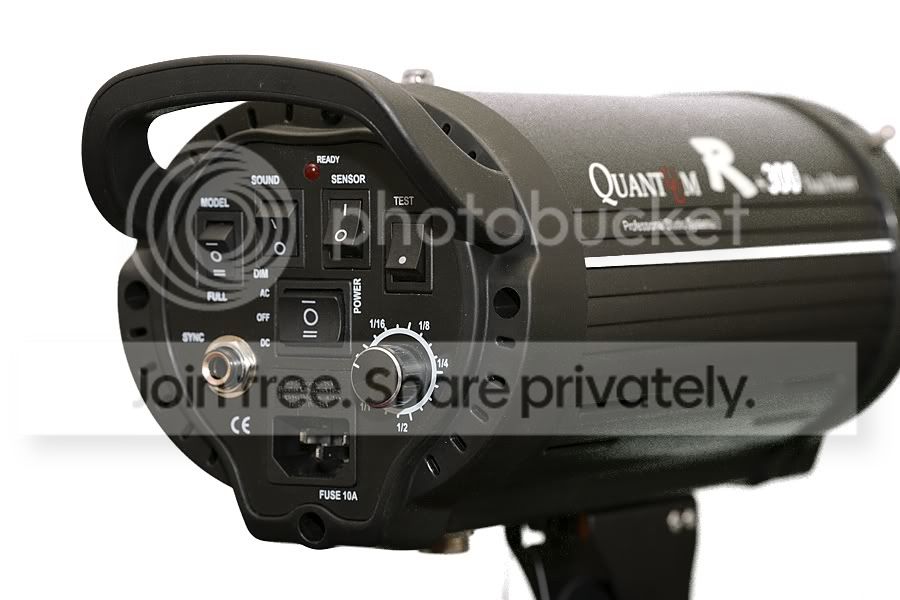

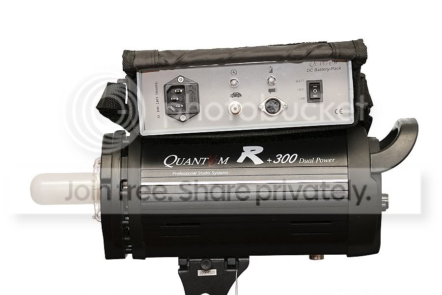

what is the connector on the output of the battery pack, going to the flash? Looks a bit dodge tbh.
How many pops at full power can you get on a full battery charge, and is the exposure consistent?
Sorry for all the questions...
How is that then? It's a sort of DIN style plug into the battery which can be pulled out if the cable is accidently pulled whilst the other end of the cable has a screw connector to fit into the bottom of the flash head.
