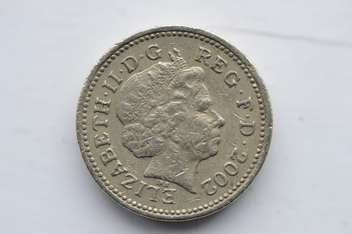

The attached photo is part of a 50 pence coin taken with my kit lens at 18mm mounted via a reversing ring. The out of focus regions at the top and bottom are caused by the angle at which the shot was taken and the depth of field was not large enough to get of all of it in focus.
There are drawbacks of using a reversing ring.
These are -
all auto functions of the lens/camera are lost so you need quite a lot of trying out different exposures to get a decent photo,
the camera to subject distance with a wide angle lens is tiny, just a few millimetres, (longer focal length lenses give a bigger working distance but the magnification is lower),
the depth of field is very, very shallow, and
not really suitable for moving subjects.

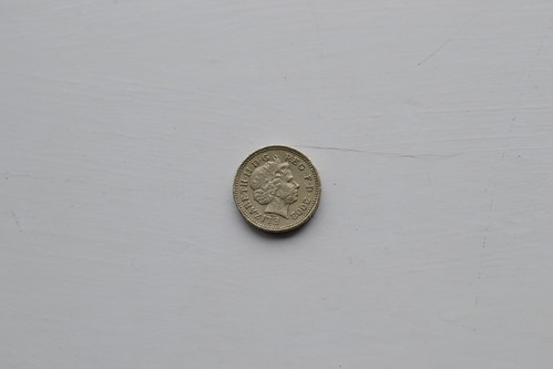

Might be worth getting a raynox m250 they cost about £40 quid on ebay
http://www.ebay.co.uk/itm/NIKON-D70...ography_Conversion_Lenses&hash=item3a856b43a8
50mm without
50mm with raynox
cheap way to do macro if your a cheapskate like me :)
