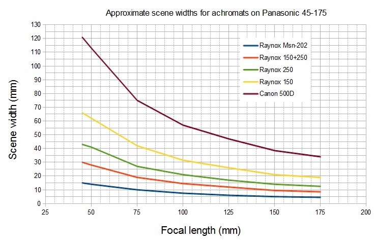

To get a complete range of coverage I use four close-up lenses. In increasing power, decreasing working distance and increasing difficulty to use these are the Canon 500D, Raynox 150, Raynox 250 and Raynox MSN-202, all used on my 45-175. This graph shows the scene widths covered by each of them on my kit. The scene widths would be different for your kit. However, I get almost the same scene widths as I did when using these achromats on a Canon SX10 (tiny sensor) bridge camera, so perhaps they wouldn't be hugely different on your kit.
I believe my 45-175 is roughly equivalent to 70 - 260 in Nikon crop terms. I got very similar scene widths with my 45-200, which equates quite closely to your 70-300 I believe. Don't know if that means you would get the same scene widths as these, but I think it might. (Of course, if you are using FF then my 45-175 equates to 90-350.)
Anyway, the graph illustrates the relationship between the four achromats.

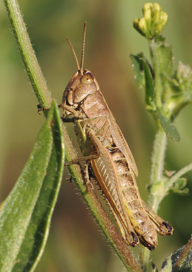

Bear in mind that when I'm talking about lenses in relation to various beasties I'm talking about getting a picture with the whole animal in the picture, often with versions which show the subject and a fair bit of its context/environment around it. Stuff like this ...
AWT 2012_05_27 08 IMG_8679 PS1 CrClBuExDf7x30CuSL21 900hSS32x0.3 by gardenersassistant, on Flickr
AWT 2012_05_27 05 P1090074 PS1 CrLetExDf7x30CuSL10 900hSS95x0.3 by gardenersassistant, on Flickr
... and things further out again, like this.
AWT 2012_05_27 06 IMG_8252 PS1 CrExDf7x30CuSL10 900hSS135x0.3 by gardenersassistant, on Flickr
I don't remember, but I would guess I probably used the 500D or the 150 for the first one and the 150 or the 250 for the other two. But I am guessing. Apart from anything else I don't recall if any of them were cropped much. Probably not, but that's another guess.
