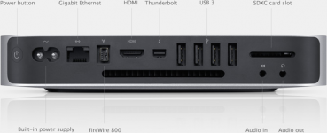

Will a 2012 Mac Mini even be able to make use of these fast speeds being talked about? I thought they were restricted to USB 3.0 with a theoretical maximum of 500MB/s...
Good point, it has a thunderbolt port though, so using a thunderbolt to usb c cable has a supposed maximum of 1250MB/s apparently.
I have a Seagate 4Tb HDD plugged into my Mac Mini. It's in a USB hub so I'm fairly sure the speed isn't that high, but it works fine for me. I leave it plugged into the wall but when it's not in use for long periods I switch it off at the hub and then it doesn't spin up at all.
What generation of Thunderbolt though? The highest sustained speed on that generation will be FW800.

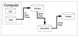

Whatever you do, I'd suggest that you consider data safety first.
Storage systems fail. As someone who worked in IT for a few decades, I guarantee that it's not a question of "if" but only "when". For many years, I've bought storage units three at a time and run them in a simple "father, son, grandson" mode...

Thunderbolt 1 which apparantly is good for 10GBps

Hmmmmmmmm well the drive's arrived and i've had to connect via usba to c as I cant seem to find a cable that will do thunderbolt to usb c :(
USB 3.2 can be as quick as Thunderbolt which should ordinarily be a USB c port does a USB c lead not fit in the thunderbolt port ? it does appear to be slightly different in having 2 corners square ? But you should still get same or very similar results connecting vis USB 3 and your USB c port on the drive. The testing i did there wasnt any significant difference between a C port and USB 3.2
As I mentioned earlier in the thread, that generation of Mac mini only supports Thunderbolt 1, the USB-C connector for Thunderbolt only came out with Thunderbolt 3.
And it's not even usb3.2, it's only 3
