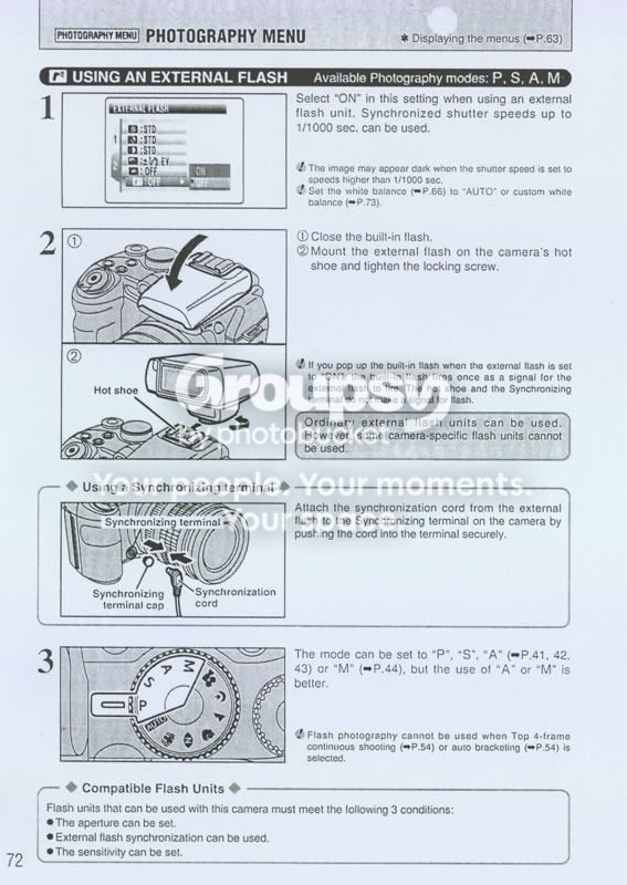

I have a Fuji 9600 camera and have just ordered a Metz 36 C-2 Flashgun, (single pin hotshoe mount), which I want to provide backlight to white background.
http://www.bristolcameras.co.uk/p-metz-36-c2-flashgun.htm
I have searched for a cable between the camera and the flashgun, I need the cable to be around 2-3m long.
Now I’m assuming all I need is a cable from the hotshoe on the camera to the hotshoe on the flash.
The Fuji has a synchronizing terminal.
Specific advice needed:
1. What type of cable do I need for this, (hotshoe to hotshoe only or synch cable or both).
2. Where, online, can I purchase these cables, (I have searched but without success).
Many thanks in advance for your help/advice.

Camera details:
At work at the moment, best I can do!
Thanks for your assistance (y)
